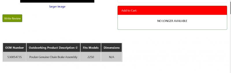

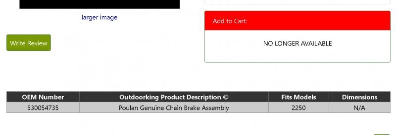

would need an example product page URL where the table should be full width but is not after editing with CKeditor to be able to see the on-page code for the table.
Here is a images before and after one is of the dev site the other is the live site that I did the change on
Attachment 20965
https://dev.outdoorking.com/chainsaw...7-35-530054735
Attachment 20966
https://www.outdoorking.com.au/chain...7-35-530054735

This is the url for the live site showing that the description is not going the total width of the page.
This is another product from the live site that shows the description field going the complete width of the page from the live site.
https://www.outdoorking.com.au/brand...-blade-blr7535
It would appear to be an issue is with the CKEDITOR 5 setting the boxes to the text size or amount going by the second link which shows the top box not going the complete width and the second box goes the complete width.
I don't understand why this is happening and would like to know how to set the table properties so that both go the with of the page. Did not have this issue with CKEDITOR 4.

The reason the table is not expanding is because it needs a width.
in your css must make the table with 100%;
#productInfo-productDescription .table {width:100%}
If your still having issue let me know but I am able to make it work on my end by just adding the table width.

This should work
File to edit
path: /includes/templates/bootstrap/css/stylesheet_zczaupost.css
paste this at the bottom of the page
#productInfo-productDescription table {width:100%;}

Just to let you know I tried it on the dev site and it works perfectly and I will add it to the live site later today.
Both boxes are showing the full length of the page.
