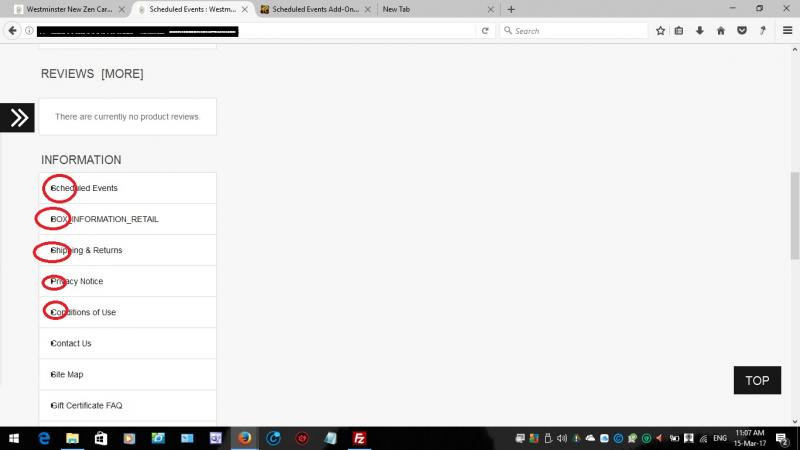

Hi there
I need some help please...??
I have installed this pluggin which i think is great ! The issue that i am having is that if you have a look at the picture attacahed the arrow cursors are too close to the text.
How can i change this please??
Thank you Attachment 16972
The scheduled events mod does not control the "arrows" but, if you post a url like yoursiteDOTcom, I can look at a fix. Probably the template.
hi there
i too think its the template.
The URL is .. www.veganfudge.co.uk
Can't duplicate the problem. What steps can I take to see what you are seeing? Looks fine in Chrome, Firefox, and Safari.
Hi there
The error i get is what is shown in the picture..... above (somewhere).
I used firefox as my Primary browser.
The error is still there in Windows Explorer, Google Chrome and opera.
Not sure why this would happen but i think it may be something to do with the template.
what do you think ?
thank you
Pictures are seldom helpful in this situation. That's why I asked for a link and the steps taken to see what you are seeing.
I see the same in all browsers.
Your best bet may be to open a post in the thread for the template.

I think the error is from the optional sideboxes files.
Because they are being merged into the existing Template files, i feel that the error is there where the file merge has not been done correctly.

I already had the link but am unable to make any browser show me what you took a picture of.Quote:
Unless you can give me precise steps to get to the same view you took a picture of, I cannot be of help. This really needs to be in another thread since it does not relate to the mod.
I suggest Westminster New thread
hi thank you.
the mod is now working fine and i dont have an issue anymore.,
I think the issue was when i was using winmerge.... i may have made the mistake.
Thank you for your help.
