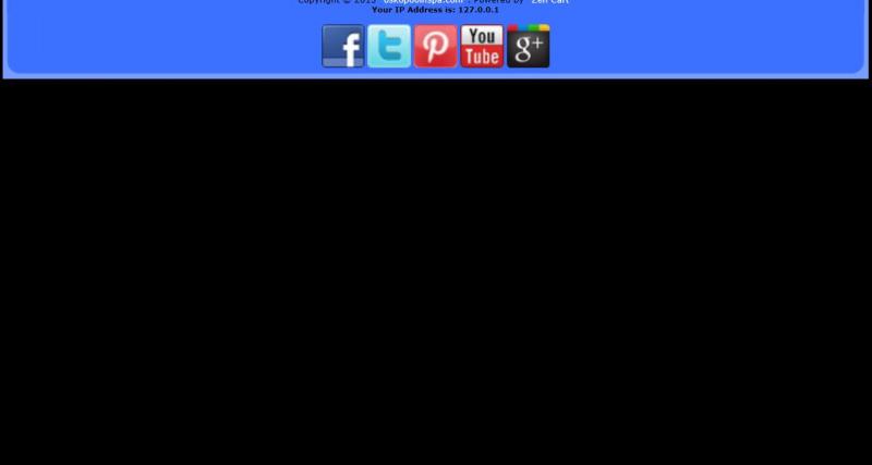

Hi Anne,
The Mega Menu was installed and worked great! However, I noticed that I had a large blank area at the bottom of every page on the website. (see pic). So I uninstalled the menu and all pages displayed normally, with only a few pixels of blank spaces which are wanted. I re-installed the menu and the menu once again worked great, but the large blank area returned.
Attachment 13246
If I simply remove the code in the tpl_header.php all pages display normally.., but when I include it I get like 12" of blank space.

Wow Anne.., your GOOD!
That is exactly what is causing it. Do you know where in the CSS that I can make the spacing between the "Shop" category titles and also the "Brands" name titles smaller?

Tried it on a fresh install of 151 too, same thing happens. As soon as I add the code to includes/templates/template_default/common/tpl header.php everything under the header disappears:
http://i61.tinypic.com/2jchjqe.png
Here is the log for that:
[15-Mar-2015 16:54:44 Europe/Paris] PHP Warning: require(includes/templates/template_default/common/tpl_mega_menu.php): failed to open stream: No such file or directory in C:\wamp\www\zencart151\includes\templates\template_default\common\tpl_header.php on line 109
[15-Mar-2015 16:54:44 Europe/Paris] PHP Stack trace:
[15-Mar-2015 16:54:44 Europe/Paris] PHP 1. {main}() C:\wamp\www\zencart151\index.php:0
[15-Mar-2015 16:54:44 Europe/Paris] PHP 2. require() C:\wamp\www\zencart151\index.php:97
[15-Mar-2015 16:54:44 Europe/Paris] PHP 3. require() C:\wamp\www\zencart151\includes\templates\template_default\common\tpl_main_page. php:73
[15-Mar-2015 16:54:44 Europe/Paris] PHP Fatal error: require(): Failed opening required 'includes/templates/template_default/common/tpl_mega_menu.php' (include_path='.;C:\php\pear') in C:\wamp\www\zencart151\includes\templates\template_default\common\tpl_header.php on line 109
Does anyone have a guess what could be the problem?

Welp, I'm trying it again (on my local server), with 1.5.4 using Annes EXCELLENT Avonlee Contempo Responsive template. I tried using the default, but was not having any success. I install the mega menu again following all steps. I got the same thing where nothing shows up after adding the code to tpl-header, so I looked at the log:
[18-Mar-2015 22:24:07 Europe/Paris] PHP Warning: require(includes/templates/template_default/common/tpl_mega_menu.php): failed to open stream: No such file or directory in C:\wamp\www\zencart154\includes\templates\responsive_avonlee_contempo\common\tpl _header.php on line 132
[18-Mar-2015 22:24:07 Europe/Paris] PHP Stack trace:
[18-Mar-2015 22:24:07 Europe/Paris] PHP 1. {main}() C:\wamp\www\zencart154\index.php:0
[18-Mar-2015 22:24:07 Europe/Paris] PHP 2. require() C:\wamp\www\zencart154\index.php:97
[18-Mar-2015 22:24:07 Europe/Paris] PHP 3. require() C:\wamp\www\zencart154\includes\templates\responsive_avonlee_contempo\common\tpl _main_page.php:116
[18-Mar-2015 22:24:07 Europe/Paris] PHP Fatal error: require(): Failed opening required 'includes/templates/template_default/common/tpl_mega_menu.php' (include_path='.;C:\php\pear') in C:\wamp\www\zencart154\includes\templates\responsive_avonlee_contempo\common\tpl _header.php on line 132
So I copied tpl_mega_menu from the includes/templates/Your Template/Common/ folder in the files that come with the mega menu package, and added it to includes/templates/template_default/common/ (I uploaded and overided all files included with the package and made sure to rename all admin folders to my admin name, I am wondering if the files just aren't being added or over written for some reason?) Now I get this:
http://i57.tinypic.com/28l5m2s.png
Does this mean the code I added to tpl_header isn't working?:
