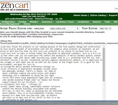

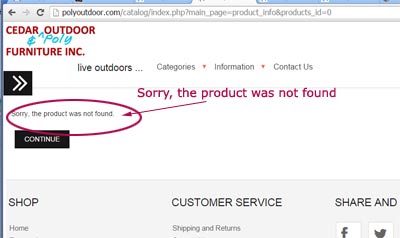

I have Zen Cart v1.5.4 and installed the Westminster Responsive template. When I look at the About Us page that should have text, it is blank with an error messaget. I entered the information in the "Define Pages Editor" (see image)
Attachment 15033
But when I view the About Us page I get a blank page and the error message "Sorry, the product was not found." (see image)
Attachment 15034
Also, in the admin, when I am in a category that I have entered and try to enter a new product by clicking on the "new product", I also get a blank page. (image below)
Attachment 15035
There is no way to enter a new product under a category.
Any suggestions?
I downloaded the template from the site and installed it myself very carefully documenting all the steps and making sure everything was uploaded correctly to the server. It was checked 3x before entering information into the admin section. I have worked with Zen Cart for about 10 years now and usually don't have this problem. You expertise would be appreciated!
Re: Winchester Responsive
suzithepid
Attachment 15033
Attachment 15034
Attachment 15035
Any suggestions?
These problems are not related to the template package. Check your logs folder for errors and correct them.
