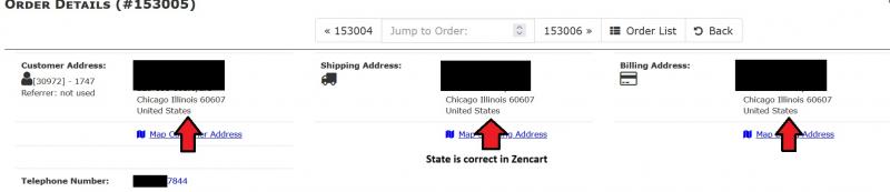

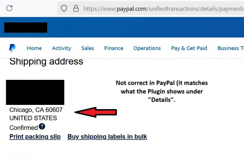

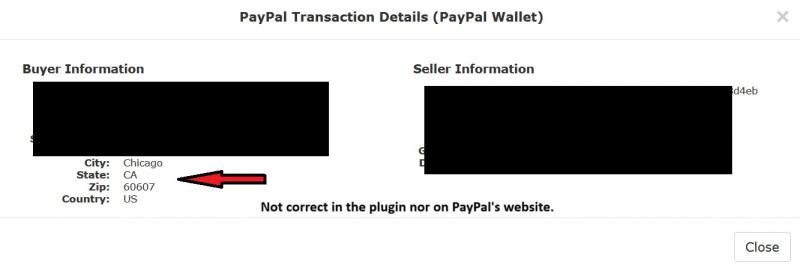

For example, I take an order through ZenCart that is shipping to Chicago, Illinois. Everything is correct on ZenCart.
But when I click on "Click for Additional Payment Handling Options" and then hit DETAILS, it shows the STATE as being "CA". Our business is in California.
See image: Attachment 20869
This doesn't happen on every order (I don't think) but it's happening a lot. Enough to be concerned, because PayPal's Seller Protection only is valid if you ship to the address that is given to PayPal, and it's giving them this incorrect state.
1) Whenever this happens to us, the incorrect state is ALWAYS put as "CA."
Is there any file I can look at which would be pushing this value to PayPal so I can see if one of us hardcoded something that is causing this? I don't understand what would be causing "CA" to be given to PayPal under the DETAILS that is pushed to them.
When you view the order in PayPal's management-console, what shows for the order's shipping address?
When I log into PayPal and pull up the order, it also has the incorrect state ("CA") which matches what the plugin shows me under "Click for Additional Payment Handling Options" --> Details.
So to recap: the state is correct in the ZenCart database (Orders --> Shipping State/BillingState). But it is NOT correct under the Plugin's transaction Details, nor is it correct when logging into PayPal to see the details. See attachments.

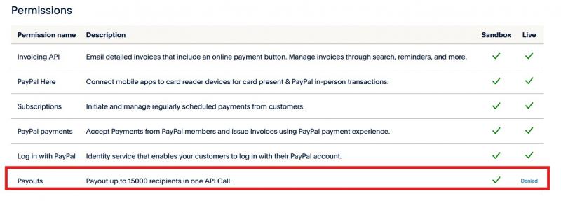

EDIT - When I look in PayPal and edit the credentials to see the details, I see this:
Attachment 20912
Could that be the issue, and what would cause that?

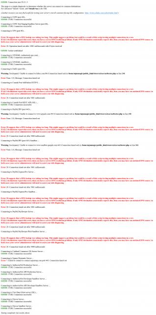

Please use the curl tester at YOURDOMAIN.COM/extras/curltester.php to test over and over again to see if you get intermittent result on connection for "PayPal Express/Pro Server" and the "PayPal Express/Pro Sandbox"
It appears to be failing in some areas....see screenshot.
Attachment 20917
Thanks Cindy. I've spent all day trying to get this to work, but whatever I do, PayPal always responds with 3ds_return, even when I cancel the transaction during 3DS verification. I give up in hope someone smarter than me (it's not like I've set the bar high...) sorts it out in the future.
Based on what I can tell, 3DS is there, but not working. Since the module isn't checking for the 3DS response nor the EnrollmentStatus, Authentication_Status and LiabilityShift parameters at all, all transactions are authorized by default (speaking of 3DS only), meaning all liability falls down to the merchant. Please correct me if I'm wrong.
In case anyone else is having CURL Connection Issues to the PayPal REST server.......
The issue in our case was that the FIREWALL was blocking a list of countries that are high risk for hacking, fraud, and malicious behavior. It turns out that RUSSIA being in the CC_DENY list for our firewall was the issue.
Why? No idea. Russia (RU) has been in our ban list for over a year with no issue. But suddenly, as of February 19th, 2025, it appears that there is some kind of relationship between Paypal REST servers and Russia.
When we REMOVED the "RU" country from CC_DENY on our firewall, wallah! We could connect to the PayPal REST server. When we put RU back on the list, the connection couldn't be made.
Hopefully that can help someone else out there. Thanks to Cindy for helping to rule out all the other issues we thought it could be. <3

In the Admin, set your transaction for AUTHORIZE (so you won't actually be charged anything).
Place an order using the GUEST checkout (for the One Page Checkout plug). Use a different state than the current state of your store location.
After your order is in your system, pull up the DETAILS by clicking the "Click for Additional Payment Handling Options" link, and hit the DETAILS button.
See if the STATE being passed to PayPal is correct or not.
For me (using ZC 1.5.8a), it will ALWAYS pass "CA" to PayPal if the user is checking out as a GUEST account only.
(If they are not checking out as a guest account, then it works fine and the correct state is passed to PayPal).
I have reported this in the GitHub but figured I'd post here in case any other users may be seeing this same behavior (with it posting the wrong State only if using a GUEST checkout.

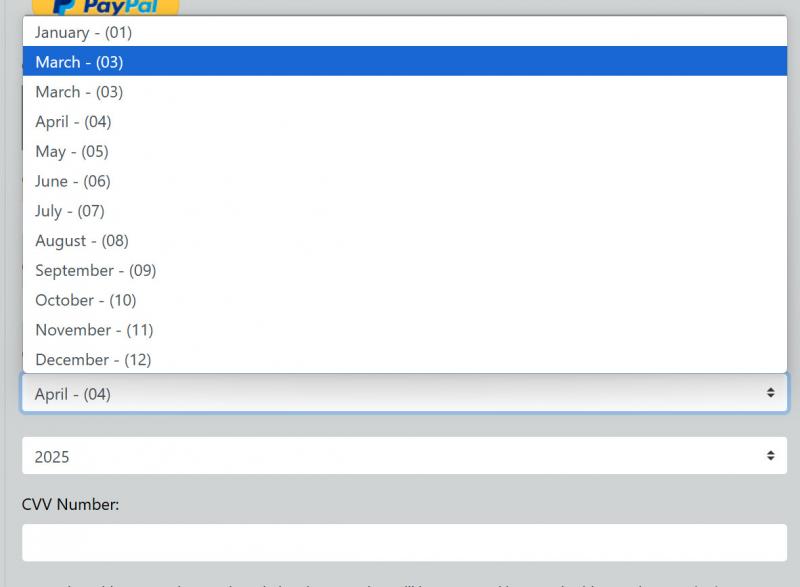

The credit card expiration field, the month of March is there twice, and there is## no expiration option for the month of February.
Attachment 20957
I found the origin of this problem, and it is not ZcDate class, but the way it is used. It is generally called like this:
Where $i is the month number. Day and year are not given as parameter which means the actual date day and year are used.PHP Code:
$zcDate->output('%b', mktime(0, 0, 0, $i)));
Problem is when actual date day is higher than the last day of a month. For PHP it is next month, like 30th of February is actually 2nd of March.
This bug only appears at the end of the month, from 29 to 31! The 31th of the month is worse case where all month less than 31 days (Feb., April, June,Sept. and Nov.) will be set to next month...
Solution is to call zcDate class output like this:
There might be other places in ZC where this needs to be modified...PHP Code:
$zcDate->output('%b', mktime(0, 0, 0, $i,1)));
For this plugin, file paypalr.php needs to be modified on lines 782 and 1269. Line 874 might need it too, not sure yet.
No modification needed on line 874!

This turns out to be a One-Page Checkout issue, where the "state_code" element of an order's address wasn't being updated for any temporary/guest addresses.
See this One-Page Checkout issue for the correction: https://github.com/lat9/one_page_checkout/issues/435
See this One-Page Checkout commit for the required change: https://github.com/lat9/one_page_che...97b93b6d7f0212
Note that the change will be released for OPC v2.5.5
