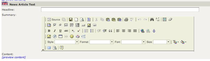

no problem with IE or safari, but the fckeditor can't show up in opera.
my other question :
How to have a bigger editing area ??Attachment 3707
