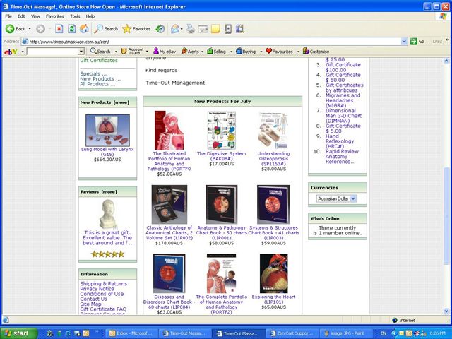

Image Resizing: Admin -> Configuration -> Images do you have calculate image size set to true?Quote:
Originally Posted by stevensmedia
Did you actually go to Admin -> Tools -> Image Handler and click on install image handler?
Thank you for your quick response!
Calculate image size is set to TRUE.
Yes, I did install the module via Admin -> Tools -> Image Handler.
Any other ideas?
