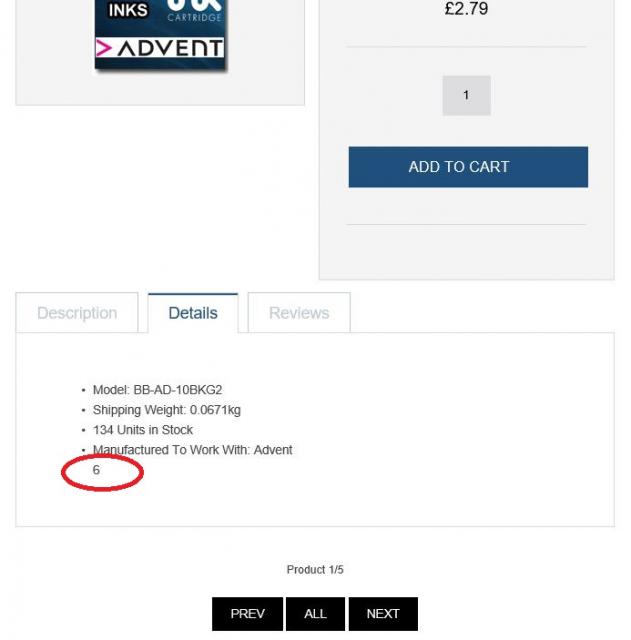

I know this is over 2 years old but here is my situation.
I'm running the latest Zen Cart and using the Responsive Sheffield Blue template.
I have successfully imported 10,000 products into my database of my new site and have it laid out well thanks to this community. I have used EP4 to import the data and have set my options in EP4 to include a user defined product field and I have imported the data I want to that field, that it working fine.
What I would like is to include this data (if possible) in the details tab like this ...
Attachment 17254
Obviously not in red LOL. After the : I would like it to get the data from the new field in the products table, the extra field is ink_ml and as said before already has the data relevant to the product.
I have followed this thread that was done back in 2015 by crazy_chris but ended up with an error on the product page so I`m not sure if anything has changed since that was written. Has anyone done a step by step guide to achieve this ??
Many thanks in advance to any help ;)
When the product was clicked all I got was a white screen with the word error at the top.
I went and checked I had put the code on correctly and made sure there was no spaces after the code, everything seemed to be in order, my first reaction was that maybe one of the files had been taken over by the theme.
Thought this had been provided previously in another thread related to a different issue, but follow the below instructions when presented with a blank screen or partial blank screen. Even if the issue is a little different than that, you can expect to find assistance in following it: http://www.zen-cart.com/content.php?124-blank-page

<?php echo $product_info->fields['ink_ml']; ?>
</ul>
<br class="clearBoth" />
Have I placed it in the correct area or is it something more sinister ?
Yet the field is there in admin when I edit a product
Okay its 2.17am and it`s time for bed.
Spent the last 30 mins or so looking at logs and rectifying the errors where I had put a , after all the ink_ml
Also the last file to edit was not the one in the default template but the RSB folder.
We now have 99% success, here is the data exactly where I want it ..

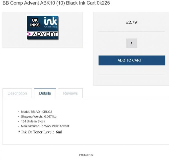

Attachment 17255
Problem is in step 3 rather than using Guarantee (In Months) I put Ink Or Toner Capacity but nothing is showing only a 6 that is coming from the database ??
Generally speaking for "home use" (meaning unless there is a specifically considered reason), it is wise never to modify the template_default files. They are a stock, backup set of files that if they do not exist in a template override then they will be used. Take the statement with a heavy grain of salt, but there are a number of benefits of not editing the file(s) that are in there, doesn't mean can't add to those files or anything else, just a benefit to leave them be. How else will you be able to compare operation of the current template to a fully functional one?
As to the display, steps 3 and say 7 or 8 are completely distinct and unrelated. The original instructions were primarily about how to get the data to and from the database. There is additional language work to be done in the tpl_product_info_default.php file and associated includes/languages directory to make your addition more language friendly if you happen to go multi-language.
Im not that bothered about multi language MC and all the steps followed have given me the result I required however that 6 on the pic above just sits there with no info what it is LOL, ideally I would want something like this ...
Attachment 17256
Other than that everything is working a treat. I was thinking there maybe a variation to step 8 to include the text before 6 fetched from the database.
Found a post on page 9 that covers my question, I must have missed that. Edit done and now working perfect. MC yet again your a star. I put 6ml in the product edit but it will not hold the ml part but I`m assuming that's down to the database field I`ll look into that but other than that perfect. Store is now ready to launch :) thanks again MC on this and all the other threads you`ve solved for me ;)
