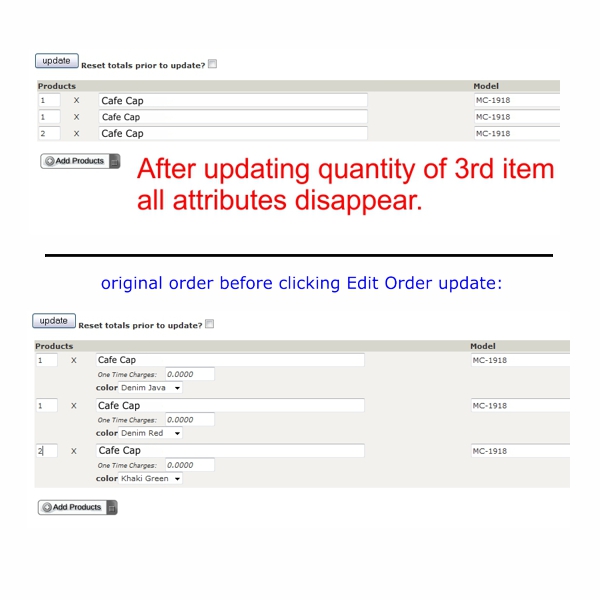

I just went into edit an order with Edit Orders with several products, some with attributes and some without, and changed the color only of one product in the middle of the list. Pushed the update button and all attributes for all products in the order disappeared.
However: when I then, edit the same order with Edit Orders, to add an item with attributes it works and the item with attribute for that item shows up in the order and the math is corrected in the order total. If you can help me get this site up... been working on it too long now... I would employ you to do so. PM me.
SBA is tracking the stock. It will not let me add things that are out of stock through EditOrders. It does let me know that items were not updated because their attributes do not exist... since those attributes were eliminated in the previous test update; but it keeps the item in the order even though there is no attribute specified as required in the normal ordering process.

Want to confirm. The product identified above that is shown as three different line items, that is a product tracked by SBA?
@athena, looks to me like there has been a change to edit orders that has caused this issue... Disabling the SBA portion of the code, a product/screen that is updated by selecting the update button has the attributes stripped from it... Still trying to work through that issue regardless.
Forgot to mention how to "disable the SBA portion". Renaming the file admin/includes/auto_loaders/config.eo_sba.php to have an extension other than .php ie: config.eo_sba.php.txt will prevent it from loading, without it loading, then the code related to SBA does not run when using edit orders. At least on the configuration I was running I had the same issue as described above where attributes of an existing product were stripped when selecting the update button from the edit orders screen. I didn't try modifying one of the attributes even or the quantity, just simply pressing the update button was enough to cause the issue.
The above issue has been confirmed as being a result of a minor bug in Edit Orders version 4.3.1 and is to be corrected in the next release. The fix is posted here in the edit orders thread.

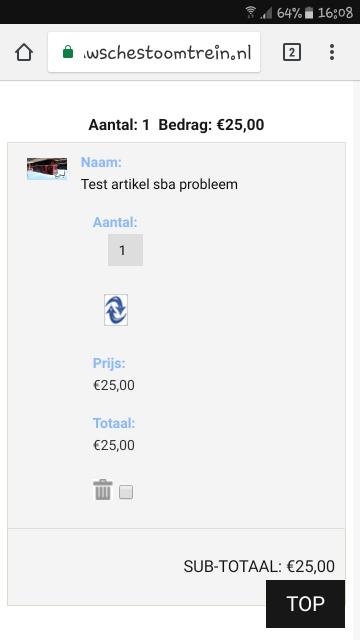

We have a problem with rounding of prices of products with attributes
One of our attributes has a price of €23.5849 excl 6% VAT ( 23.5849 * 1.06 = €24,999994 )
the SBA lists a incl price of €25,00
however if we add one to the shopping-cart it is listed as €24,99
Please advise us to what possible solutions there are

We have this problem only with products that use SBA.
The price in orders_products gets rounded to 2 decimals somehow, where the pricein orders_products_attributs is shown correctly
see icture, top is orders_products, below orders_products_attributes

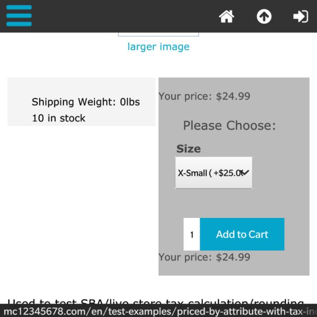

For your system, can you show data for a product that is setup with similar price-by-attributes conditions but is not assigned to SBA as a comparison? Please include both the data of the page information (whether it shows 24.99 or 25.00) and the purchase result data as provided above.
When the product is not tracked by SBA, then the built in ZC calculations and processing are used. If there is a difference in display of the two product (tracked with SBA and not) at the product page display, then please identify the number of attributes assigned to the product and the configuration settings for Dynamic Dropdowns. This last piece of information is to understand the setup and either provide guidance on a change or correct the code, it is not to suggest (yet) changing those settings.
Attachment 18001To partially answer the above question, from my mobile device I setup a product that was not tracked by SBA on a ZC 1.5.5f system that has Dynamic Price Updater installed (note that DPU uses the shopping cart class to identify the price which is displayed at the upper portion of the screen). Added a tax class and associated settings for a 6% sales tax, display the price on the store front with tax included, and added a product priced by attributes with a single attribute having the price of 23.5849.
The result (seen in the attached image) is that the product price is shown as 24.99, but the attribute's price shows as 25.00 which is the same values reported in the previous posting.
Conclusion? SBA does not cause the displayed price difference. Unfortunately it also doesn't "fix" it either (yet). As said before there are some calculation differences that have been identified in the software that show themselves in different areas. For the most part it is a result of the multiple ways that calculations are performed, carrying of significant figures and various independent and integrated methods of calculations. For those that remember their math days, generally speaking the system of equations is overdetermined causing there to be insufficient degrees of freedom to find the one solution to each of the sought after number values. Ie. In one case looking for the exact value of the tax and at the same time the overall price to pay or in the case of VAT the price of each product before taxes and after taxes as well as the tax itself. There is likely to exist one or more occurrences where quantity, price, and tax will not all "add" up. This is pretty much regardless the software system being used. There are ways to prevent such issues from generally being seen, but...

We are using the ZEN cart to sell tickets for our steamtrain.
there are multiple products that sufferfrom this problem.
when i look in orders_porducts table i see all SBA related prices at 2 decimals rounded
the products that are affecte have two options,
the customer has to select a date and a type of card ( children, adults etc )
prices for products without SBA get noted in orders_products with all 4 decimals

here is the product with the SBA
Attachment 18002
here a test-product without the SBA
Attachment 18003
both have the same bruto pricing, but different results as seen
I realize that you have a problem that you want fixed and while SBA doesn't currently fix the problem, contrary to the original post about the problem, SBA doesn't cause it and truly is unrelated to it. I am able to say this from independently performing the following tests:
It appears that I didn't give good direction on how to setup a product that has all of the same characteristics as the original reported, but is not Stocked by Attributes. So, I did this, but it also means that you should still do this to prove to yourself what I am saying.
Starting with a ZC 1.5.5f system. I went into configuration->my store and set the display price with tax for store and admin to true. I then created a tax rate and associated zoning to be able to apply a 6% tax rate to product. I then created a product that is enabled, priced-by-attributes, has a 0 price, has the tax rate just created, and has a quantity of 100.
I then went through the save process.
I went into the attributes controller for that product and added a single attribute of option name size and option value of small. I set all buttons on the attribute except for display only and required. I added a price to the attribute of 23.5849.
I saved the attribute.
I verified that I had the shipping option of in store enabled and the payment of check/money order enabled. Neither of these adds a price to the overall operation working like a digital product (for shipping).
On the store side, I now went through the purchase process for the product. The product page showed a product price of 24.99, the attribute showed 25.00. Going through checkout, using pickup in store and check/money order, the shopping cart showed 24.99 all the way through to checkout success with tax being 1.41. After checkout, looking at the orders_product for the order, it was shown as 23.5800, the orders table reflected a total price of 24.9948 and the orders_products_attributes shows 23.5849. This is before SBA was even installed. Which means that SBA as I said, does not cause the pricing problem that you are seeing... it is something that exists already in the ZC software.
Further, when I attempted to create a product that didn't have attributes (and therefore wasn't priced-by-attributes and also not controlled by SBA) that had a "final" (gross) price of 25.00, it had a net price of 23.5849. On every page except for the confirmation page the price showed as 25.00. On the confirmation page the price showed as 24.99...
The rounding is occurring in includes/classes/order.php within the function cart() where the final_price is being set at:
'final_price' => zen_round($products[$i]['price'] + $_SESSION['cart']->attributes_price($products[$i]['id']), $decimals),
and where $decimals is set at the beginning of the function as:
$decimals = $currencies->get_decimal_places($_SESSION['currency']);
For the Netherlands this results in a 2 decimal quantity being set for the products final price. SBA doesn't modify either of these values. Then after the assignment of final_price to the product, the overall price to collect from the customer is "calculated" which in this case results in the loss of a "penny". Perhaps ZC should behave differently when the price of the product includes the taxes (such that the ORDER_PRODUCTS table is populated with the four decimal value instead of rounding to the current currency).
Anyways, most of the above really should be addressed outside of this forum and I recommend that you continue to seek resolution and perhaps a global solution for all conditions, but outside of the Stock By Attributes forum.

I have applied the above changes to a v1.5.5f site, it seems that the changes to includes/classes/class.products_with_attributes_class_stock.php are causing problems. The error I get when adding a SBA attributed product to the cart (from the product info page) is
[23-Sep-2018 15:08:12 Europe/London] Request URI: /my-category/my-product?number_of_uploads=0&action=add_product, IP address: 127.0.0.1
#1 trigger_error() called at [\www\mydomain.co.uk\includes\classes\class.products_with_attributes_class_stock.php:793]
#2 products_with_attributes_class_stock->zen_sba_attribs_no_text() called at [\www\mydomain.co.uk\includes\extra_cart_actions\stock_by_attributes.php:787]
#3 include(\www\mydomain.co.uk\includes\extra_cart_actions\stock_by_attributes.php) called at [\www\mydomain.co.uk\includes\main_cart_actions.php:26]
#4 require(\www\mydomain.co.uk\includes\main_cart_actions.php) called at [\www\mydomain.co.uk\includes\init_includes\init_cart_handler.php:44]
#5 require(\www\mydomain.co.uk\includes\init_includes\init_cart_handler.php) called at [\www\mydomain.co.uk\includes\autoload_func.php:48]
#6 require(\www\mydomain.co.uk\includes\autoload_func.php) called at [\www\mydomain.co.uk\includes\application_top.php:170]
#7 require(\www\mydomain.co.uk\includes\application_top.php) called at [\www\mydomain.co.uk\index.php:26]
[23-Sep-2018 15:08:12 Europe/London] PHP Warning: SBA product can not have any attributes in \www\mydomain.co.uk\includes\classes\class.products_with_attributes_class_stock.php on line 793
[23-Sep-2018 15:08:12 Europe/London] PHP Stack trace:
[23-Sep-2018 15:08:12 Europe/London] PHP 1. {main}() \www\mydomain.co.uk\index.php:0
[23-Sep-2018 15:08:12 Europe/London] PHP 2. require() \www\mydomain.co.uk\index.php:26
[23-Sep-2018 15:08:12 Europe/London] PHP 3. require() \www\mydomain.co.uk\includes\application_top.php:170
[23-Sep-2018 15:08:12 Europe/London] PHP 4. require() \www\mydomain.co.uk\includes\autoload_func.php:48
[23-Sep-2018 15:08:12 Europe/London] PHP 5. require() \www\mydomain.co.uk\includes\init_includes\init_cart_handler.php:44
[23-Sep-2018 15:08:12 Europe/London] PHP 6. include() \www\mydomain.co.uk\includes\main_cart_actions.php:26
[23-Sep-2018 15:08:12 Europe/London] PHP 7. products_with_attributes_class_stock->zen_sba_attribs_no_text() \www\mydomain.co.uk\includes\extra_cart_actions\stock_by_attributes.php:787
[23-Sep-2018 15:08:12 Europe/London] PHP 8. trigger_error() \www\mydomain.co.uk\includes\classes\class.products_with_attributes_class_stock.php:793
