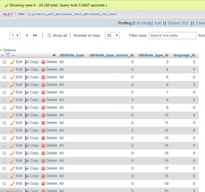

So I grabbed the files from
https://github.com/mc12345678/Stock_...butes_Combined and uploaded them to my site. I ran the above script and looking in and the attribute type is set to AV, Still no luck. On test product I have set the qty for each color individual. for test2 product I just made pick a color at 100 units I have in the out of stock that white is out. Still any color i click on will tell me out of stock when i try to click to add it to the cart.

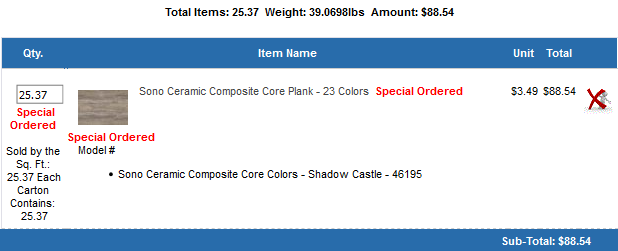

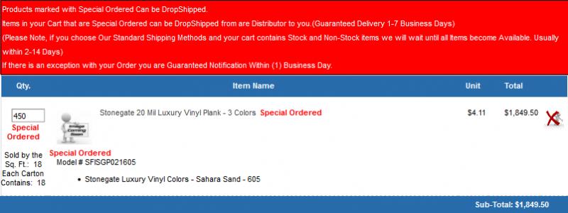

when a product is out of stock, mark_product_out_of_stock it looks at products_quantity to determine this, A splash screen in red shows up and informs the customer, and the products are marked out of stock(Special Ordered) how can i also get it to look at the attribute stock, and show that same splash screen. some of the attributes are instock and some are not but the products quantity has quantity from the ones that do.
this is when no product quantity Attachment 18079
and this is no attribute quantity Attachment 18080
i modified a shipping module to detect out of stock to ship another way so having a problem looking at attribute stock to determine
