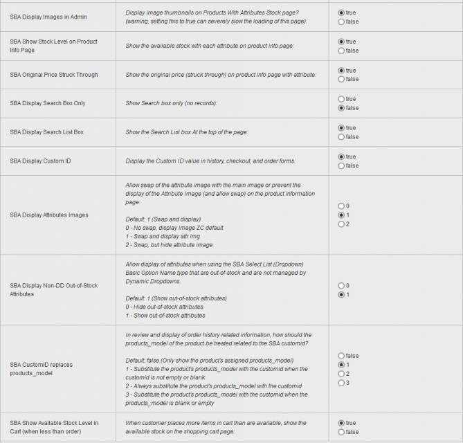

Ok, so there are a few settings in both areas that are not defaulted, but they don't appear as if they would cause a stock availability issue.

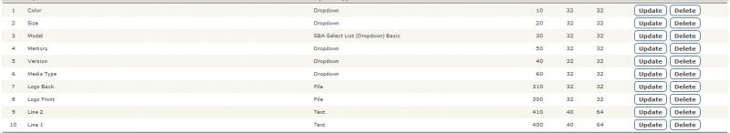

In mentioning the link above, I went to it just a few minutes ago where I only saw one attribute assigned to it. By having only one attribute, then the display option name type assigned to the attribute would be the one used to attempt to display the availability of stock. The attribute (model) appears to be of the default dropdown or select option name type. Type add-to-cart button at the top of the screen doesn't seem to complete the add-to-cart action where it tries to add the 200 square feet that I have estimated needing to complete the "whatever" it is calculating.

Umm. Okay, so before I saw this message I was going to say that it seems like there may be something with the added dropdown menu and perhaps either a recent change or something related to using single attributes. But then there is the statement about the option name being empty... could you further elaborate? Also, are you also seeing an issue if there are two or more option names assigned to a product and the product populated with stock?

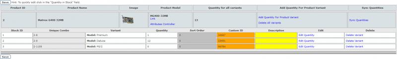

What does the stock screen look like for the product sample identified above? Ie. The variant(s) and quantities assigned?
some of the errors from w3c i believe are from the Out of stock name instead of name set in option value manager, the other version designed for 1.51 works, wanted this 1 for the picture changing and to show custom id on product page
Attachment 18361Attachment 18362
