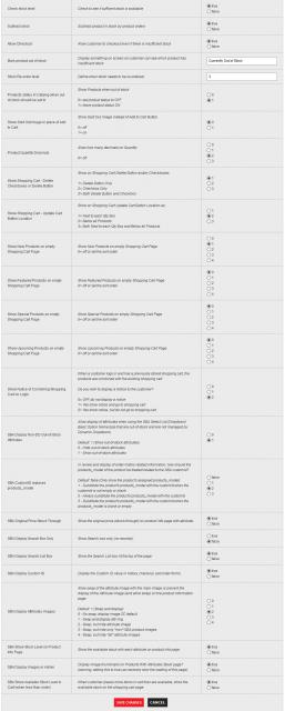

What are the settings related to sales of product when the product is out of stock? (configuration->stock)

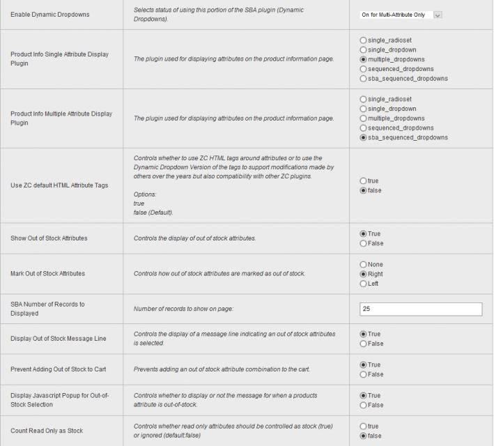

If you look at the installation screen that is created in the configuration menu, what script option may appear to provide the desired visualization?

when i change from on for multiple attribute only to any other setting the message shows up on screen but no popup1

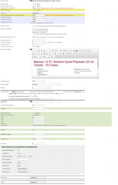

only thing i did was install go to option name manage and put in on sba tracked and add variant to product. stock settings. same as previous pictures

Settings in configuration->stock

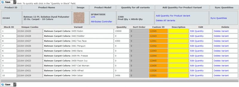

Quantity applicable to the variant(s) in question and separately the quantity of the base product (ie. Quantity in the product information page in admin which is also reflected in the products with attributes screen. That is found on the row that provides the product name and products_model.)
Then another question that doesn't seem to be answered (again, I likely could be wrong) is how many option names are being used with the product in question? (though having asked that, I went to the link which for those interested indicates one option name. This means that considering the settings provided for dynamic dropdowns in the images above that the SBA simple dropdown is the code area to be applied and responsible for display of information.) from there I collected this image, so trying now to determine what specific issue is in question right now?

when product is added to cart and you view cart i do not see custom id nor do i see regular model number
same product on live site with sba 1.53, https://jnsflooringandsupplies.com/i...ducts_id=22164 add to cart, view cart and custom id shows.
