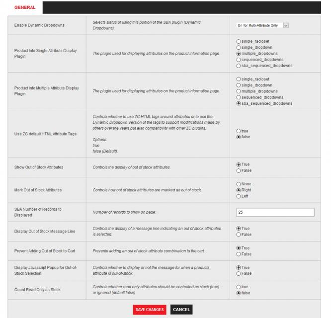

Also if I set the pick a color as read only then in SBA I can not select it to add a qty to.
Read only or display only? (read only is an option name type, display only is a setting in the attributes controller.)
As to not being able to add quantity to a display only attribute, that is by design. The original idea was that if not able to select the option to add it to the cart, then how could it have a quantity? Now with this concept of using the non-stock option, that may need to be revisited in some way.

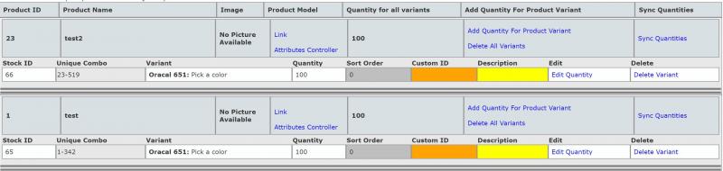

So if for each item I set up the quantity for each color individual it will work. Attachment 18076
If I set just the pick color so it will run SBA Attachment 18077
it only shows pick color in stock and all others are out of stock.
Attachment 18078

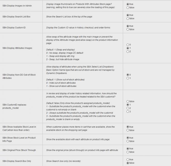

im using Stock_By_Attributes_Combined-master in zen version 1.51 from the github link, dynamic dropdown setting are defaulted to whatever they r set in installation.
i setup database with demo products,
stock settings
Attachment 18359
dynamic dropdowns
Attachment 18360
i am using the this product for testing
http://jnsflooringandsupplies.com/WO...&products_id=2
Ok, so there are a few settings in both areas that are not defaulted, but they don't appear as if they would cause a stock availability issue.

What does the stock screen look like for the product sample identified above? Ie. The variant(s) and quantities assigned?
some of the errors from w3c i believe are from the Out of stock name instead of name set in option value manager, the other version designed for 1.51 works, wanted this 1 for the picture changing and to show custom id on product page
Attachment 18361Attachment 18362

anyway here is a product
https://jnsflooringandsupplies.com/W...9848c951be1939
when i change from on for multiple attribute only to any other setting the message shows up on screen but no popup1
only thing i did was install go to option name manage and put in on sba tracked and add variant to product. stock settings. same as previous pictures
Have seen the images above and gone back to try to review previous images. A few questions asked don't seem to be answered. If I missed the answer, I apologize.
Settings in configuration->stock
Quantity applicable to the variant(s) in question and separately the quantity of the base product (ie. Quantity in the product information page in admin which is also reflected in the products with attributes screen. That is found on the row that provides the product name and products_model.)
Then another question that doesn't seem to be answered (again, I likely could be wrong) is how many option names are being used with the product in question? (though having asked that, I went to the link which for those interested indicates one option name. This means that considering the settings provided for dynamic dropdowns in the images above that the SBA simple dropdown is the code area to be applied and responsible for display of information.) from there I collected this image, so trying now to determine what specific issue is in question right now?
Well, sorry, appears I would exceed my image quota by attaching. At any rate, it was an example of a selection stating that the selection was out-of-stock and showed the customid in parentheses.
sorry had to run off this morning didnt finish uploading
Attachment 18375Attachment 18376Attachment 18377

mc12345678,
On the Admin Products with Attributes Stock page, each row in the variant column consists of two lines.
