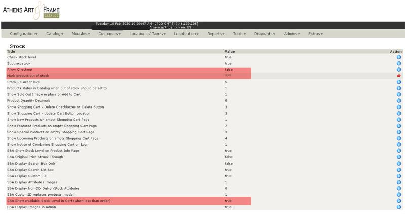

Just found another new issue. Focusing on the highlighted lines in Config > Stock
Attachment 18858
Allow Checkout is technically working, except it is saying that everything is out of stock, despite SBA showing otherwise, and the product page showing the correct total in stock of all variants together. IE: For a 4x6 frame, I have it set to 5 units in stock, the product page is showing 30 (which is all my variants added up), but when I do a test order, it doesn't matter if I say I want 1 or 10, it says it's out of stock regardless. If I set "Allow Checkout" to "true", then the order goes through, but the *** for "Mark product out of stock" shows regardless of order quantity.
"SBA Show Available Stock Level in Cart" likewise is not showing ANYTHING, though I suspect its problem is tied in to the above issues.
