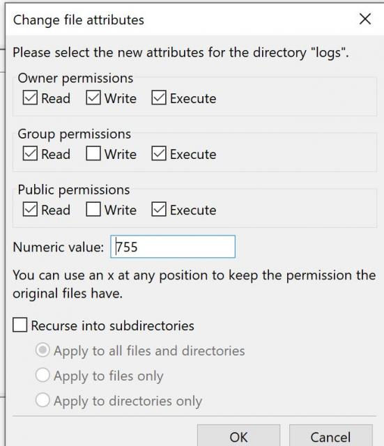

The /logs directory permissions should be 755 (rwxr-xr-x); the method that USPS uses to write its logs is different from the PHP error logging.
What version of Zen Cart and PHP is in use?
Re: USPS Shipping Module [Support Thread]
v1.5.5a of Zen-Cart with PHP version 5.6
The attributes of the /logs shows the value 755. See screen shot attached.Attachment 20345
