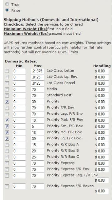

Ok, so here's what is working better right now. First I worked on the USPS config, and the final is:
Attachment 12837

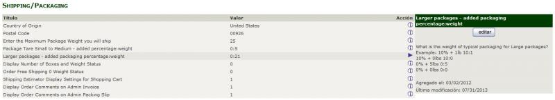

Then, I worked on the shipping config (which I really KNOW-NOTHING about, so I just guessed), here's what I ended with:
Attachment 12838
First to answer your question on how I will ship 1/messenger bag and 2/sandals? I will have to use 1 medium for the handbag and sometimes 2 boxes of sandals may fit into a Lg F/R box but not always, so I will have to use 2 Md. The store owner doesn't have a problem of loosing 2-3 bucks in the shipping but 2 x 20 is $40 so I will try to be as much accurate as I can. Anyway they usually offer many discount coupons and specials which are really good deal to shoppers.
Now back to this issue. With these settings if someone buys 2 sandals and one messenger bag, it will be 3Md boxes $37.05. If they order 1/1 it will calculate 1Lg box $16.85.
Now the problem is that if someone orders 3 perfumes (18#) it should calculate Md box, and is going to the large one.
So maybe if I understand better the Shipping/Packaging settings and the percentage:weight formula, I will pin this down. :unsure:

Ahah. Look at your Tare for small packages. It is adding 5 pounds to every box to account for box weight, packing materials, overhead, etc. That would explain 3 perfumes going to a Md box... 3 x 6 pounds plus 5 pounds = 23 pounds. Max package weight is probably limiting the LG FR to 25 pounds and I haven't a clue what the logic does when 25 pounds is exceeded. So 20 pounds fits a Md FR and 25 max for a LG but that actually limits the LG to 20 pounds product plus 5 pounds tare. If you only use FR boxes, tare weight may not be an issue and could be reduced significantly or possibly zeroed.

Well, I made the change on the Md FR max to 18.50 and I put a tare of 2:0 to small - medium package and the other one left it like that. That's working quite well on the estimates.
