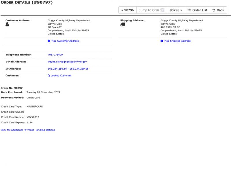

Re: Square WebPay support thread.
Payment Module installed DID A RE-UPLOAD OF THE UPLOAD FOLDER, worked perfectly after that.
**BUT**
Every order that used the previous square mod wont display ANY of the order details!! ??
Attachment 20157
It's completely blank under and after the payment details.
UPDATE orders
SET payment_module_code = 'square_webPay'
WHERE payment_module_code = 'square';
It's throwing a error log:
[19-Nov-2022 20:17:11 America/Chicago] Request URI: /XXkcaz00/index.php?cmd=orders&page=1&oID=90795&action=edit, IP address: 184.170.174.172
#1 square->token_refresh_check() called at [/includes/modules/payment/square.php:505]
#2 square->getAccessToken() called at [/includes/modules/payment/square.php:816]
#3 square->lookupOrderDetails() called at [/includes/modules/payment/square.php:456]
#4 square->admin_notification() called at [/XXkcaz00/orders.php:881]
#5 require(/XXkcaz00/orders.php) called at [/XXkcaz00/index.php:11]
--> PHP Warning: Use of undefined constant MODULE_PAYMENT_SQUARE_APPLICATION_ID - assumed 'MODULE_PAYMENT_SQUARE_APPLICATION_ID' (this will throw an Error in a future version of PHP) in /includes/modules/payment/square.php on line 544.
--> PHP Warning: Use of undefined constant MODULE_PAYMENT_SQUARE_ACCESS_TOKEN - assumed 'MODULE_PAYMENT_SQUARE_ACCESS_TOKEN' (this will throw an Error in a future version of PHP) in /includes/modules/payment/square.php on line 546.
#1 square->isTokenExpired() called at [/includes/modules/payment/square.php:559]
#2 square->token_refresh_check() called at [/includes/modules/payment/square.php:505]
#3 square->getAccessToken() called at [/includes/modules/payment/square.php:816]
#4 square->lookupOrderDetails() called at [/includes/modules/payment/square.php:456]
#5 square->admin_notification() called at [/XXkcaz00/orders.php:881]
#6 require(/XXkcaz00/orders.php) called at [/XXkcaz00/index.php:11]
--> PHP Warning: Use of undefined constant MODULE_PAYMENT_SQUARE_TOKEN_EXPIRES_AT - assumed 'MODULE_PAYMENT_SQUARE_TOKEN_EXPIRES_AT' (this will throw an Error in a future version of PHP) in /includes/modules/payment/square.php on line 525.
--> PHP Warning: Use of undefined constant MODULE_PAYMENT_SQUARE_TOKEN_EXPIRES_AT - assumed 'MODULE_PAYMENT_SQUARE_TOKEN_EXPIRES_AT' (this will throw an Error in a future version of PHP) in /includes/modules/payment/square.php on line 526.
[19-Nov-2022 20:17:11 America/Chicago] PHP Fatal error: Uncaught Exception: DateTime::__construct(): Failed to parse time string (MODULE_PAYMENT_SQUARE_TOKEN_EXPIRES_AT) at position 0 (M): The timezone could not be found in the database in /includes/modules/payment/square.php:526
Stack trace:
#0 /includes/modules/payment/square.php(526): DateTime->__construct('MODULE_PAYMENT_...')
#1 /includes/modules/payment/square.php(559): square->isTokenExpired('-15 days')
#2 /includes/modules/payment/square.php(505): square->token_refresh_check()
#3 /includes/modules/payment/square.php(816): square->getAccessToken()
#4 /includes/modules/payment/square.php(456): square->lookupOrderDetails('90795')
#5 /XXkcaz00/orders.php(881): square->admin_notification('90795')
#6 /XXkcaz00/index.php(11): require('/home/feadmin/p...')
#7 {main}
thrown in /includes/modules/payment/square.php on line 526
--> PHP Fatal error: Uncaught Exception: DateTime::__construct(): Failed to parse time string (MODULE_PAYMENT_SQUARE_TOKEN_EXPIRES_AT) at position 0 (M): The timezone could not be found in the database in /includes/modules/payment/square.php:526
Stack trace:
#7 {main}
thrown in /includes/modules/payment/square.php on line 526.
barco57 - Where would this be resolved at? Appreciate your feedback.
wait... I need to run a query to change the previous.... correct?
