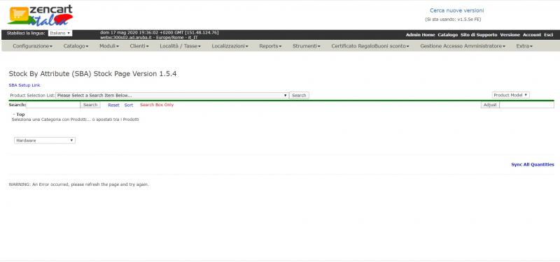

So I've managed to get everything installed, merged, and working mostly happily, the only issue I'm getting now is when I try to put in my second attribute variant, the page crashes and I get:
WARNING: An Error occurred, please refresh the page and try again.If you were entering information, press the BACK button in your browser and re-check the information you had entered to be sure you left no blank fields.

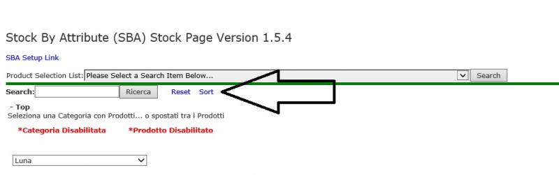

Hi everyone sorry for my english, I speak Italian I use google traslator, I ask you for help I updated installed zen cart 1.5.5e Italian version, I inserted the SBA module Version 1.5.4, I loaded all the files correctly and then installed from the path "stock_by_attr_install.php" after I ran the first "full upgrade install" script and immediately after also "non - stock DB Table Install" no error appears, at this point even if I try to create new articles with attributes if I go to the aka page SBA I see the search boxes but no list of articles appears, I get this message: WARNING: An Error occurred, please refresh the page and try again.
I had tested this form before making the transfer by purchasing a web space and it seemed to work, when I actually had to do the transfer it no longer works ... who can help me is 3 days that I try to get out of it but I can't, I'm not an expert, maybe it takes special permissions to folders?
I copy the server data if it can be useful to understand

I have many logs so I did a search for an item in catalog -> aka SBA in order to generate the error I copy below:
[18-May-2020 18:06:03 Europe/Rome] Request URI: /TEST2/password/products_with_attributes_stock.php?search=&pwas-search-button=Search&search_order_by=products_model, IP address: 151.48.100.0
#1 trigger_error() called at [/web/htdocs/www.miosito.com/home/TEST2/includes/classes/db/mysql/query_factory.php:167]
#2 queryFactory->show_error() called at [/web/htdocs/www.miosito.com/home/TEST2/includes/classes/db/mysql/query_factory.php:139]
#3 queryFactory->set_error() called at [/web/htdocs/www.miosito.com/home/TEST2/includes/classes/db/mysql/query_factory.php:266]
#4 queryFactory->Execute() called at [/web/htdocs/www.miosito.com/home/TEST2/password/products_with_attributes_stock.php:1012]
[18-May-2020 18:06:03 Europe/Rome] PHP Fatal error: 3065:Expression #1 of ORDER BY clause is not in SELECT list, references column 'Sql1427045_2.d.products_name' which is not in SELECT list; this is incompatible with DISTINCT :: select distinct pa.products_id FROM products_attributes pa, products_description d, products p WHERE d.language_id='2' and pa.products_id = d.products_id and pa.products_id = p.products_id AND ( p.products_id = '' OR d.products_name LIKE '%%' OR p.products_model LIKE '%' ) order by d.products_name ==> (as called by) /web/htdocs/www.miosito.com/home/TEST2/password/products_with_attributes_stock.php on line 1012 <== in /web/htdocs/www.miosito.com/home/TEST2/includes/classes/db/mysql/query_factory.php on line 167

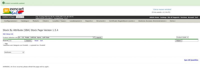

i downloaded latest version on https://github.com
I made the changes you sent.

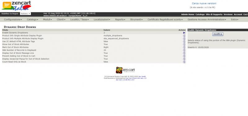

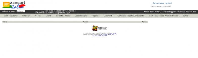

I performed a new 1.5.5e Italian FE installation, I loaded the sample products in the shop, I uploaded the Stock_By_Attributes_Combined-master files, I ran SBA setup link -> full / upgrade DB install dynamic drop down and here I check the first one problem seen in photos Configuration -> Dynamic drop downs I can't find anything Attachment 18990
after install from -> SBA setup link -> non-stock DB table install and now it appears

if now I go to Catalog -> aka SBA the list appears but without division of the attributes and quantity
Attachment 18993
if i try to load quantities in any item i return to error.
Attachment 18994.
the only way to remove the error is to remove everything from the db.
help me understand what and where am i wrong i made the steps many times always same problem. copy last log:

I have resolved this one issue I believe with https://github.com/mc12345678/Stock_By_Attributes_Combined/pull/76/files
Operation is expected to be with the default settings in Dynamic Dropdown at least for selection of what handles what type of attributes, with selections made from things such as to display available stock or not, etc...

I ask you for help, I read and reread what you wrote and I tried before writing again, but for me it is too difficult.
I try to explain myself:
I go to catalog -> option name manager type of option SBA Select List (Dropdown) Basic settings as in the photo
Attachment 19025
The visualization of the image attributes (colors) in the article page, I only get it with single attributes, or with Dynamic DropDowns off (0) if I have multiple attributes (sizes + Colors) I cannot get the display of the attributes (color images ), my shop must have size and color, the colors I wanted to see on the product page. Is this possible with SBA?
to disable the exchange of the original image with the attribute (color) on the cart page, I understood that I have to manually change the code to 0 but I did not understand in which file I must search.
Forgive me but I can't solve it, thanks again for your help.
snakes7575
I'm sorry, I tried to try alone to solve this last problem of mine, maybe the translation of google traslator is wrong or it is I who am I can not understand.
Attachment 19025
Actually, that was very well stated and I fully understood it.
The problem is that currently Dynamic Dropdowns does not fully support image swapping without making some code modifications. I've worked out something of a solution, but there also are a number of ways for images to be captured/stored for display, whether it is stacking images atop each other, merging the images as appropriate and storing those merged images, etc...
Right now I have it so that as an option is changed the image changes either to the image that is assigned in the attributes controller for that one option value. I am trying to identify a way to do a lookup based on the selected attributes; however, I'm getting to a turning point where I may have to do a bit of work to make that happen, not to mention that I will need to modify one of the tables and add features in the admin to be able to address/update the images.
I was able to make a minor modification to the code to support attributes image swap for dynamic dropdowns; however, as identified image swapping seems to work for multi-attribute product, provided dynamic dropdowns are not active which also has an impact on customer interaction..
Thank you MC for your answer and explanation, sorry but I did not understand initially I thought of my configuration error.
I will observe github when you make new changes.
Thanks for your patience and the work you do.

4 Attachment(s)
SBA Version 1.5.4 for Zen Cart Version 1.5.6c
Have some issues with this and cant work out what's going on.
Please see pics below
Pic no1 shows the SBA page for an item on my site. The quantities on this page are correct.
pic no2 shows the option dropdown for the product on the website. As you can see these options are NOT correct according to the SBA page...
pic nos 3 and 4 display same pics for a different product. Again the stock on the SBA page are correct but the options drop down on the product page are wrong as well...
Have same issue with some of the other products in this category too, though not all of them...
ANY IDEAS ???

Took a moment to identify the presence/absence of all of the images. For those that are unable to see the pictures for whatever reason, please at least allow me to describe two of them as the other two tell the same story.
In the first image, we are shown the admin screen portion of SBA for the given product where there are three rows of data showing quantity for each of three different option value selections within a single option name. The quantity of stock is different for each of the three option values which is also different than the total quantity of stock marked as available for the product stock quantity. In a second image, we are shown the catalog side of the store showing the product information page with all of the attributes assigned to the product and the stock quantity identified to each attribute (option value off of the one option name).
In this second image though there are more than three selections displayed. Here there are 10 or more selections displayed. The quantity of stock entered for the firs three shown in the admin match, but the other 7+ displayed options all appear to have the quantity that the overall product has...
This *is* a feature of SBA... it may not be usable in some stores, it may cause complete confusion in others, but it is part of the design. The concept is this: to limit the sale of quantity of product, one must identify the quantity of product that is available. By not defining the individual quantity, the quantity available is that defined by the product.
Thus, to remove the availability of the other option values, either the option values should be removed from the product or the quantity available for each of the option values should be identified even if it is a quantity of zero.
Of course, even with a quantity of zero, there comes the question of whether the "product" should be displayed. If the answer is no, I ask the question of why the option value remains assigned? If the answer is yes, I suggest reviewing the out-of-stock options to be sure that they "one day" will be returned to stock.
Sorry for the delay in responding, it's been a long day, but from the design perspective what you are seeing is "correct"... it may not fit your store or desired expectation but is functioning as designed/expected.

These are the setting for the dynamic dropdowns as requested:
Attachment 19247
