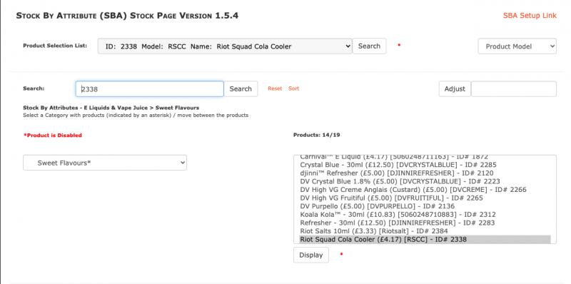

I have the latest SWA from Github on 1.5.7b, and am having a problem with search. Entering the product model no. into the search box brings the product into the search list box, but doesn't display it on the page. Clicking search on the product, which is now in the search list box, brings it up on the page for editing, but gives this error.
PHP Fatal error: Uncaught Error: Class 'language' not found in /admin/includes/classes/products_with_attributes_stock.php:267
function displayFilteredRows($SearchBoxOnly = null, $NumberRecordsShown = null, $ReturnedProductID = null) {
global $db, $sniffer, $languages;
if (empty($languages)) {
267 $languages = new language();
Can anyone help with this?
Didn't have this issue at times in the past with some version of ZC 1.5.7, but I agree that there is the above issue. Pushing the commit change in a moment. Don't like the solution or perhaps it is the fact that such a solution has to be generated, but it does take in consideration of the history of Zen Cart unfortunately...

Fix that has worked for me is by applying the changes identified in the following: Address missing language class in ZC 1.5.7b · mc12345678/Stock_By_Attributes_Combined@a41d979 (github.com)

Thanks for your reply, and for all your work on ZenCart.
The search works with the first edit, but gives the error
--> PHP Warning: Illegal string offset 'id' in /admin/includes/classes/products_with_attributes_stock.php on line 503.
The search works with both edits, but gives the error
--> PHP Warning: Illegal string offset 'id' in /admin/includes/classes/products_with_attributes_stock.php on line 506.
Re: Stock by Attribute v4.0 for Zen Cart 1.5.1+
Using the `zen_get_languages` function in your last edit fixed it. Great that the solution didn't add weight either.

As well as the above queries, having installed the module, I'm getting the following log file generated when viewing products_with _attributes_stock page in admin.
PHP Fatal error: 1064:You have an error in your SQL syntax; check the manual that corresponds to your MySQL server version for the right syntax to use near '))' at line 1 :: select count(distinct p.products_id) as total FROM products p, products_description pd WHERE pd.language_id=1 AND p.products_id = pd.products_id AND (p.products_id IN ( )) ==> (as called by) /Users/developer/Sites/localhost/mysite/myadmin/includes/classes/split_page_results.php on line 39
It looks like it's missing part of the query.

First off, need to look into what is causing that logged issue, certainly something is amiss there, even if the value within the parentheses should be 0, it well shouldn't be because no products_id should be 0. That said, there have been occurrences of databases losing their auto-numbering and then therefore a new product gets assigned to the products_id of 0.
As to the fileset, yes, there is only one admin file that is modified and it is only modified to support the use of an image swap plugin that needed to have the notifier that was included. I was asked to incorporate it long ago and so it remains in support of that site's use and potential further development for the community.
There *are* a few files on the catalog side if you want to use the provided dynamic dropdowns. Basically, after I did more testing and had seen additional "issues" of not keeping each ZC file up-to-date, I did what I could to divorce the code of the plugin from the core/template of ZC without losing any of the existing features of the plugin... There are some ways to remove the tpl_modules_attributes.php modifications, but its going to take me some work because for one, once I do that the "background" for displaying the information is going to get a serious overhaul. There are other better "dropdown" tools out there that could be incorporated with/against javascript/jQuery and that's the path/route that would need to be taken to basically remove the edits from that file.
As to not needing the other files for ZC 1.5.7 that are included in ZC 1.5.6? Well, I finally took advantage of some ZC version specifics... ZC V1.5.7 added a new style of observers and a few more observers were added in general. Now, if one hasn't updated to the latest of 1.5.7(c) then there may be some "features" missing. But because older versions don't have all of the same notifiers and do not process notifiers the same way, they currently need the extra edits and files (until either they also get updated or everyone upgrades. :))
Anyways, please read this post for more of the details that I likely missed above: https://www.zen-cart.com/showthread....68#post1380068

I have a quick query regarding the initial products_with_attributes_stock page.
Below the text Stock By Attributes - Top there is a dropdown where I can select a category. Making a selection here will open the products_filter select which displays all the products within that category.
I'm trying to figure out the difference between the 'Search' button above the select, and the 'display' button to the right of the select.
Both seem to have the same end result of displaying the selected product. Can one of these be removed, or is there another purpose for one or the other that I am unaware of?
If one can be removed, which button label would you prefer to stay. IMO, 'display' seems to make more sense as you are not actually searching for anything at this point, merely making an option selection from what's presented in the select.

@mc12345678
A quick preview of the modified layout for the first section of the page (pending your response re the 'search' button.
Attachment 19591
