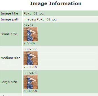

AIS is working on my site, however I've setup the images sizes in the admin->config, yet when I use AIS to upload the images it resizes them to squares... hmm what am I doing wrong?
Attachment 4502
Attachment 4503
Attachment 4502
Attachment 4503
Looking through this thread the problem is with the way the resize code is calculated. Images which are portrait are resized skewed (too thin).
Jcode I'm sure you're busy, but it wouldn't take long to quickly updated the code, especially as people are donating to you (hope you enjoyed your sushi from me!)
For the solution see page 26
http://www.zen-cart.com/forum/showth...=84145&page=26
