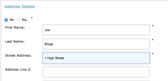

The first picture is of the New Customer section of the Login screen, showing the *s for required fields at the end of the fields, which is clear enough.
Attachment 16050

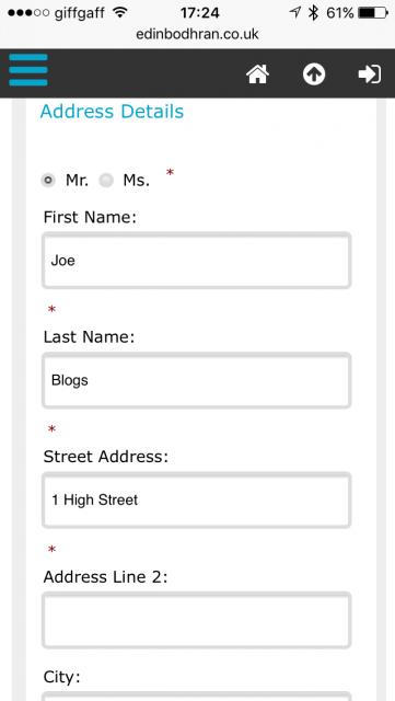

The second picture shows the same screen on an iPhone 5.
Attachment 16051
Unfortunately the *s end up on a line by themselves and it's not totally clear which field they apply to. Would it be clearer (and possible) to put them after the text label?
i.e.
First Name: *
[ Text Field ]
Last Name: *
[Text Field ]
etc.

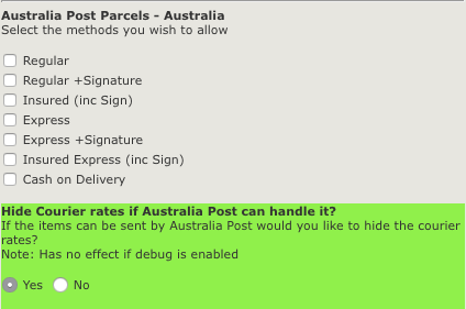

I'm encountering a lot of difficulties in getting OzPost shipping module to work in v155.
Obvious signs of failure is the repeatable effect of wiping out checkbox options if they are changed, leading to an inability of the module to provide shipping estimates - in fact the options don't appear at all in the shopping cart or at checkout.
Before Update showing checked boxes
Attachment 16043
After Update showing all checkboxes have been cleared
Attachment 16042
Note that the radio button which was changed from No to Yes shows yes after updating as expected
Examination of the Configuration table shows that the checkboxes are represented in OzPost records as arrays and are set using this function, stored in the set function field for that record e.g.:

In v154 the Ozpost code works just fine but in v155 since at least January 13 it has been failing.
