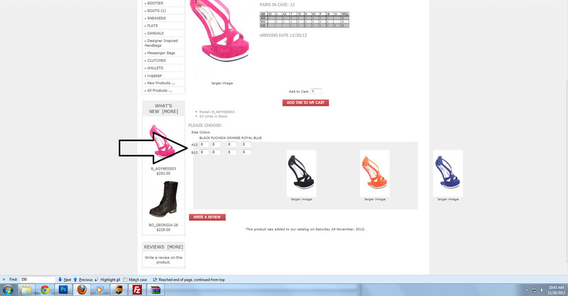

how can i fix this? i have uploaded several times the files and is not working properly. is it
because i have Image Handler 4?the detail pics as well are off please help

Re: Product Attribute Grid
@21yanks,
The module isn't very well suited to attribute images, since it is formatted for a grid pattern. You might try separating your products into a separate color for each, then do an attribute for sizing.
Or, you can add your images to the main product additional images. As long as the colors are fairly obvious I think you won't have any problem. The sample you show here is quite clear which color I would be ordering as a consumer.
