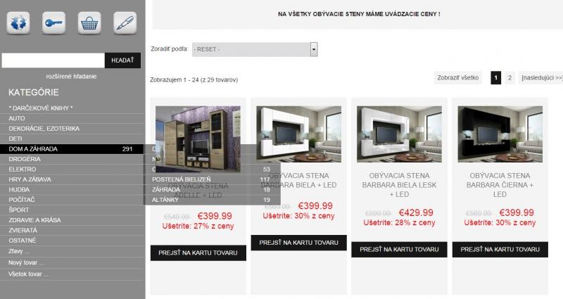

Hi Anne.
I have just found out a little bug.
Lets say Im in a category, where my products are listed. Now, when I move the cursor to my categories and the subcategories names show up, some of them are hidden behind the images of actual products displayed.
Please see the image to understand what I mean :
Attachment 15502
Is anyone else having this issue, or is it only me probably messed up something?
Thank you,
Peter

Hi Anne.
Attachment 15502
Thank you,
Peter
Thank you for posting. This is a bug and I have noted it to be fixed for a future update. The z-index of the sub menu needs to be increased. If you post a link to your site I can post the code you need to add.

kabko
In stylesheet.css around line 207 add to #categories .sideBoxContent ul li ul li
position:relative;z-index:11;
