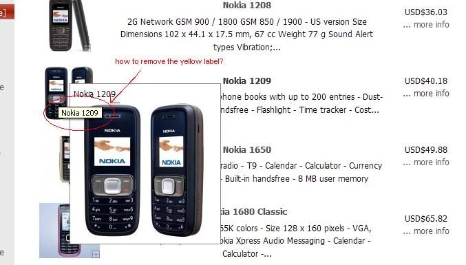

anyone can help to remove the yellow label? when i hover the mouse over the image.. thank you!
http://img.photobucket.com/albums/v1...04/instant.jpg

vaige
I think that this "yellow label" is caused by an alt tag originally included in the image.
Nothing wrong with it, it will help you with search engines and vision-impaired people.
I would just leave it there, but you can delete image, remove alt tag in original image and reupload.
Re: Image Handler 2 Support
Thank you for your reply!

ckosloff
how to remove the alt tag in original image???
caborela
The alt tag is an HTML tag, it's not in the image itself.
I thought about this post, it looks more like it's displaying a title tag that an alt tag.
The title for the image is probably being input by a program, not IH, it doesn't behave like that.
For more info on this, I will defer to tophand.

caborela
More on this: this label you see popping is nothing more than the article's name or title.
That is the way IH is supposed to work; if you don't like it, you need to hack the code, but, again, that thing is there to help you.
