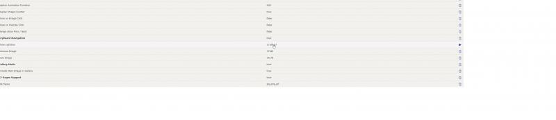

I have a problem with my zencart 1.5.6c install and zenlight box 1.6.5. When i try to edit the options for in admin , some options only show a blank area where you edit the options for it. Attachment 18939 And it creates a mydebug file for it
[10-Apr-2020 22:00:27 America/Los_Angeles] PHP Parse error: syntax error, unexpected '"27,88,67"' (T_CONSTANT_ENCAPSED_STRING) in /home/user/domainfolder/admin/configuration.php(207) : eval()'d code on line 1
[10-Apr-2020 22:00:27 America/Los_Angeles] Request URI: /admin/configuration.php?gID=55&cID=1447&action=edit, IP address: 162.234.204.230
--> PHP Parse error: syntax error, unexpected '"27,88,67"' (T_CONSTANT_ENCAPSED_STRING) in /home/user/domainfolder/admin/configuration.php(207) : eval()'d code on line 1.
How do i fix this ?
Zen Lightbox is pretty old and currently, to my knowledge, unmaintained. Might I suggest using Zen Colorbox (https://www.zen-cart.com/downloads.php?do=file&id=1322) instead?
