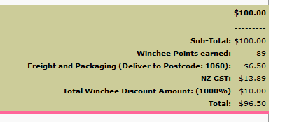

Cool, thanks for the suggestion worked a treat, but now brings up another issue:
When the order is confirmed & process it is not processing the correct points - still deducting the points of the points earned (weird number as well) - shows on inv as below & only allocates the incorrect number to pending points
Attachment 14870
Really driving me insane this - mod is great except for this issue - Anyone HELP!!

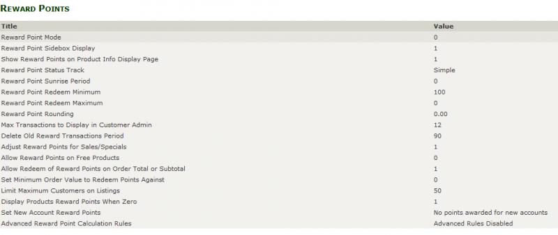

Setting wise: I have left it as basic as possible screen shot below except for the "Global Reward Point ratio:" which is set at 1.1500 to account for our GST figures - I have duplicated the issue on my local test system as well. Copy of settings:

Product Price inc tax: $115
Freight and Packaging: $7.48
Tax content 15%: $15.98
Total Reward Discount Amount: (2000%): -$20
Total: $101.50
Winchee Points earned: 92
Issue I have is with items in red:
Tax is wrong - should be $13.24
Points earned are incorrect - should be 95
I have tried moving the discount field up above the tax, but still no joy - tax display still incorrect & points still stay at 92
These figures also show on invoice
Anyone got any ideas - help would be appreciated
