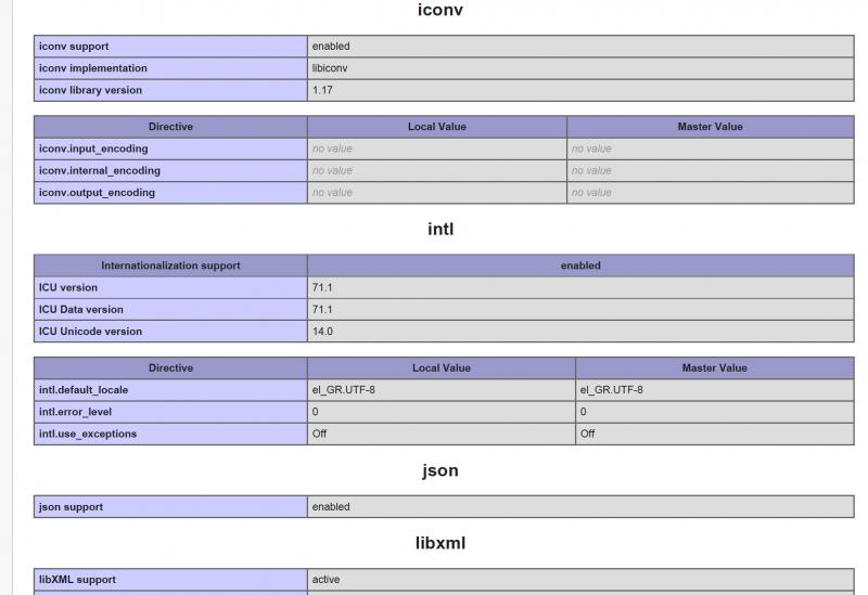

Hi Guys,
timezone-identifiers available from @lat instructions are listed at the end. The important for my case is Asia/Nicosia, Europe/Athens, which are available.( Running Joomla 4 system report, on same PHP, it shows also Europe/Nicosia and UTC as default timezone. Joomla has no problem with the PHP 8.1.1).
The actual timezone declared in php.ini is date.timezone = "Europe/Athens"
The Intl extension is also available.
I entered also in php.ini
[intl]
intl.default_locale = el_GR.UTF-8 which it had no effect on the issue.
Attached also screenshot From info.php
Attachment 20608
