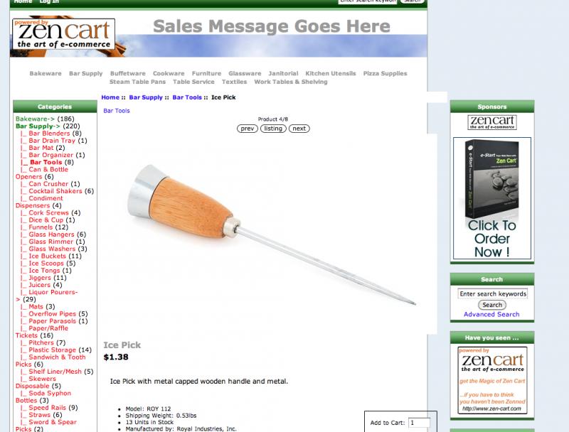

I am seeing similar results with the additional images vs only oine image however its like it resets it.. if i use the next product link on my site ones that work work, then i'll hit one that has one image and it doesnt then I go previous, then forward and the image is then re-sized..
its very strange...
can't suss your though.. I cant get any to display 50 x 50..
for example, this page, your html source code is showing:
http://96. 30. 58.67/index.php?main_page=product_info&cPath=6_148&products_id=1151&zenid=d0d30ebcd1e6 4c6234e12a368f3d9e36
<script language="javascript" type="text/javascript"><!--
function func (img) {
if(img.height >= img.width) {
img.style.height = "50px";
img.style.width = "auto";
img.style.width = "50px";
img.style.height = "auto";
document.write('<a href="images/barsupply/roy-112.jpg" class="bonzer_zoom" rel="product_info"><img src="images/barsupply/roy-112.jpg" onload="func(this);" /></a>');
//--></script>
and this is the image..
Attachment 11906
REALLY.. REALLY.. WEIRD!
Philip:
What is weird is when you click back and forth with PREV <> NEXT, the image scales to 50 x 50 and zoom works correctly, but if you REFRESH the page, the image is show FULL size!
It HAS to be because somewhere your variables are not being reset. So the LAST value (for one of the dimensions) is being retained... this is my thought on what's happening...
I'm stumped.. We need a java/jquery guru to help implant the size switch better.
or simply a break ...
Either way, you've made some really great progress!
