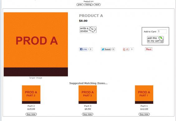

Re: Multi Cross Sell mod [Support thread] Not displaying correclty in IE
I have installed Multi Cross Sell and it seems to be working fine except for how it displays in IE. (see images below).
I cannot seem to figure A) what is happening or B) how to fix it.
The URL for the item is here: http://www.abacuspub.com/shop/index....roducts_id=170
Any thoughts?
David Attachment 10479Attachment 10480
Daviator
It works in ie6 and ff12
In ie8 it breaks, but lines up ok in "compatability mode"
btw: ie6 is the only one that shows 3 across correctly
The padding appears to be wrong in the others!
It would appear to be a CSS problem but I can't quickly see what it is.

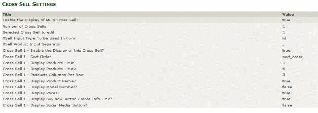

admin->configuration->Cross Sell Settings
Be aware there is some confusion regarding how many you need.
Most websites will be fine with just ONE as it can handle tens of thousands of cross sells
You ONLY need more, if you want to have a different text header that is shown on the cross sell

Hi, I've installed 1.02 on Zencart 1.3.9h it works but I have a problem:
1. the header of each cross sell soes not show up (like "Suggested Matching Items...")
2. how and where could I change this title?
You can see it in action here: http://tinyurl.com/d5h768d
Thanks for your help!
Stefano

Just read through all 348 posts and hope I didn't miss my problem.
All installed and working for Cross Sell 1, with heading etc.
Have then added 'Number of Cross Sellls' to 2, which worked.
However after choosing products to cross sell (appears to add them ok with confirmation), the "We also Suggest" heading doesn't show and neither do the products from that cross sell group. Though they are listed as cross sells in admin.
I do note that under Cross Sell Settings, the 'Selected Cross Sell to edit' only gives a 1 check box and can't be changed to 2 (missing the 2 box)
Any idea? Thanks and awesome mod. Well done on your hard work :)
deziner76hd
Where can I change the wording in the header "Suggested Matching Items..."
You can go to Tools in admin, then Developers Toolkit and type those words in "Look Up...." (or similar in 1.3.9)
That will give you the location of that text.
It is here though: /includes/languages/english/extra_definitions/YOUR THEME/multi_xsell_box_defines.php

Before I start I wanted to thank you for your contribution.
Running Zen Cart 1.5.1
I installed the “multi_cross_sell_v1.03” plug-in without any problems. This is a fresh install without any prior similar plug-ins.
<!-- BEG: Multi Cross-Sell mod -->
// THIS CODE WOULD BE ADDED INTO YOUR TPL_PRODUCT_INFO_DISPLAY.PHP WHEREVER YOU WANT TO DISPLAY ALL THE CROSS_SELL BOXES:
if(defined('MXSELL_ENABLED') && MXSELL_ENABLED == 'true') {
for ( $mxsell = 1; $mxsell <= MXSELL_NUM_OF_TABLES; $mxsell++ ) { // show all cross sells
require($template->get_template_dir('tpl_modules_multi_xsell_products.php', DIR_WS_TEMPLATE, $current_page_base,'templates'). '/' . 'tpl_modules_multi_xsell_products.php');
<!-- END: Multi Cross-Sell mod -->
I placed the above php code before "/form"
I created 4 products, 1 main product called “PRODUCT A” and 3 parts called “Part 1”, “Part 2” & “Part 3”as follow:
ID for “PRODUCT A” is 24
ID for “Part 1” is 25
ID for “Part 2” is 26
ID for “Part 3” is 27
Under admin/catalogue/Multi Cross Sell, I created a new cross sell as follow:
Attachment 11781
Under admin/configuration/Multi Cross Settings, my setup is as follow:
Attachment 11782
When I select “PRODUCT A” I see the following under the “product_info” page
Attachment 11780
So far so everything is OK.
Question 1) Why is it when I select, add to cart, in the above scenario, “Part 2” gets added to the cart instead of “PRODUCT A”? I have tried this many times on different products and it seems to add the first product on the left from the “Suggested Matching Items…”! What have done wrong? What am I doing wrong?
Question 2) Is there any way to code in and get a “Quantity Box” instead of “Buy Now” button on the product_info_display page only, so the customer could have the choice of picking the quantities of the items he needs to the cart from this page, instead of going back and forth to add related products?
Kevin205
You need to move the </form> as well.
See post 364
Kevin205
Could be done (but hasn't as I didn't require it)
