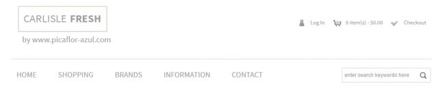

how do I change the color and thickness of this horizontal line?
Attachment 16365
Re: Carlisle Fresh Template Support Thread
Got it
changed this line in stylesheet.css
#headerWrapper{border-bottom:3px solid #ff2600;}
biju
Got it
I am happy that you figured it out and posted your solution ;)

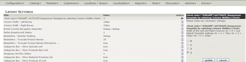

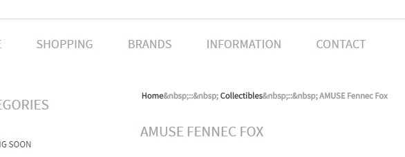

When I go to config>Layout settings and enter the values
and click on save, it shows up as "&nbsp;::&nbsp;" and affects how my breadcrumbs look
Attachment 16742
