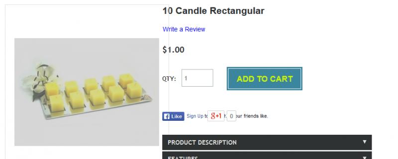

Hello, I've setup a test bed and installed zen cart 1.54 and the latest version of tableau 1.5.2. I then added products and when i view the products, the product name and other product related info is overlayed on top of the product image. Here is a pic:
Attachment 15467
This is a fresh install of zencart, tableau and the only other modification is that I added ezpopulate 4.0 (the version located on github)
At first I thought it was because something did not upload correctly, but I have completely started from scratch now 3 times. The first two times were with zen 1.54 and tableau 1.5.2 The last attempt was with tableau 1.5.1 thinking there was something wrong with 1.5.2. Unfortuantely, this resulted in the same problem.
I also tried comparing css from my test site and the demo site on numinix.com
I also installed this locally with xampp and this problem occurred. I then did fresh installs on my hosting account thinking there would be a difference between the xampp installation and my hosted account. Unfortuantely, the results were exactly the same. I now only have this installed locally so I don't have a link to provide.
If anyone else has experienced this problem and resolved the issue, I would appreciate your assistance.

I am having the same issue on only some of the products... I haven't really dug into it yet but I think it has to do with the size of the image for that item...
You can see it here on this item - 17-076
and not here on this item - 17-074
I'm thinking image issue due to the fast the degree of overlap varies... see here - 20-013

Is there a way to make the product description box wider with out moving the product item name and qty on to a new line?
Thanks in advance
Enzo, not sure if you have solved this but I have the same issue and here is the solution that seems to work.
in the file: product_info.css found in ../templates/tableau/css
find:
Obviously change those values to match and line up for your site but those values work for my site straight out the box.Code:#productMainImage a { ...........
and add the following:
max-height: 350px;
max-width: 330px
overflow:hidden;
Best of luck.
Michael
