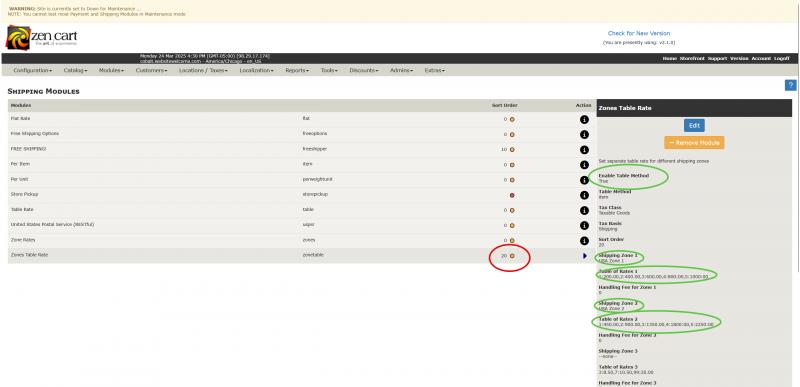

I have the latest version of this plugin, but its showing as disabled (orange color dot) in shipping modules and does not show up on my products with the set zones. When clicked it does say: Enabled. Not sure if its working or why it would show a green disabled dot yet is listed as enabled.
See pic.
Attachment 20937
I see you have lots of activated shipping modules.
You can't use everything parallel
A couple of things:
- orange doesn't mean disabled. It means zone-restricted.
- you're trying to test in down for maintenance mode. Don't do that - take the site out of maintenance mode.
Thank you both for your feedback. Will test it out of maintenance mode and have already removed several of those plugins, all others are disabled.
