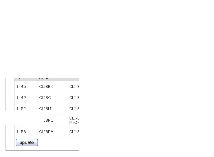

I installed multi cross sell and it worked great. at some point I was trying to get another module to work (ceon_uri-mapping) and I couldn't get it to work so I deleted the product data base tables and then reloaded them. It didn't fix the uri mapping problem and now multi cross sell no longer displays on my product page. When i go into catalog>multi cross sell it has cross sell data loaded but it doesn't display. I tried removing and reinstalling multi cross sell but it doesn't change anything. Don't know what I did to break it.
Post a direct link to product page that you know (and have checked and confirmed) has a cross sell for it.
Re: Multi Cross Sell mod [Support thread]
Having done this...The cross sells are working for the items that are listed in "list current cross sells" I guess the issue I am having is not all of the cross sells are being uploaded. They are in my management system but not all are being populated I guess. Must be a problem with my upload. Thank you so much for the support.
