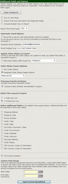

ZC 1.5.1. The easy stuff first:
What code in export_shipping_information_V1.3.2.1/"shipping_export.php" do I change to set the below as defaults?
(Obviously not the 10 things I tried :yuck:
1:
Product per row.
(Currently set to Order per row)
2:
Include Header Row In Export.
(Currently you have a check box)
3:
Full Product Details

Re: Export Shipping & Order Information
It technically shouldn't matter what order any of those are installed in UNLESS, one of them has a "delete" type of command that in unknowingly removes some database field(s) from other modules (I've seen this before with a number of mods.)
To set defaults on the selection items you need to add another portion to the function for drawing either the radio fields, checkboxes etc...
Specifically you would need to add something that follows this pattern "$variablenamehere=true"
An example of how you would select by default the type of file layout would be
ORIGINAL LINE OF CODE:
<?php echo zen_draw_radio_field('filelayout', '2' );?> <?php echo TEXT_FILE_LAYOUT_PPR_FIELD; ?><br />
CHANGE TO:
<?php echo zen_draw_radio_field('filelayout', '2' , $filelayout=true);?> <?php echo TEXT_FILE_LAYOUT_PPR_FIELD; ?><br />
Notice the addition of the ", $filelayout=true" portion of code.
You would do the same for the checkboxes (adding the appropriate variable = to true for each that you wish to pre-select.
Example for checkbox would be:
ORIGINAL LINE:
<?php echo zen_draw_checkbox_field('product_details', '1');?> <?php echo TEXT_PRODUCT_DETAILS_FIELD; ?> <span style="color: #ff0000"><strong>*</strong></span><br />
CHANGE TO:
<?php echo zen_draw_checkbox_field('product_details', '1', $prod_details_checked=true);?> <?php echo TEXT_PRODUCT_DETAILS_FIELD; ?> <span style="color: #ff0000"><strong>*</strong></span><br />
Notice addition of the ", $prod_details_checked=true" portion.
Let me know if that helps.
Thanks for the default code. Nothing like what I was trying. :blush: I'll try yours later today.
econcepts , That is purrrfect! THANKS!
You have just taught this man how to fish (for the little ones) :cool:

I have included a snapshot of the settings.
Attachment 13850
Is there something that I can do to stop this from showing?

I modified in my code to achieve the results pictured. My MODIFIED shipping_export.php.zip is attached.
Attachment 13851
Sorry but I did not comment my changes. You'll have to compare this to the original shipping_export.php.
Attachment 13852Attachment 13853
