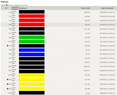

I've had several years of the 1.0 version successfully processing many transactions. Thank you for such an excellent port! With the most recent upgrade, I am experiencing an issue that cptok said may happen.
I've successfully upgraded my cart to 1.3.9h. After confirming that, I upgraded QBMS from 1.0 to 1.9. Ran a legitimate production transaction and it processed without a hitch creating one order. Since that test, I have had three duplicate orders/transactions. One duplicated the order and the QBMS transaction, which I had to manually refund. The other two only had duplicate orders (different order IDs) yet the customer's cards weren't charged twice.

All the files have been checked with WinMerge and are identical. I'm having to "cancel" the duped orders and that doesn't actually cancel the order, putting the product back in stock and removing the sale from the sales reports. Anyone have any advice?

I have attached an image showing the Orders area with the duplicate orders. Another three order dupe yesterday. Colors are dupes, black is a normal order.
Could it be that people are pressing the complete/submit order button more than once as they wait for the server to respond? Thanks!

This is in regard to my previous posts 393 and 394. After quite a bit of diagnosis, the problem was rooted in the email setting.
After our site's successful upgrade, we enabled SMTPAUTH as our email setting. It had run on PHP successfully for a few years. Even with the correct settings SMTP and SMTPAUTH would not work and was causing duplicate orders within the QBMS module. Paypal was not affected because the user was directed away from our site for the credit card processing.
Again, this is all due to incorrect email settings, not the QBMS module. Thanks again for a very solid contribution. We used 1.0 up until last month without a hitch.
