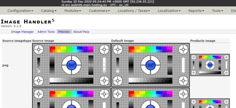

ok so i've copied these files over now and the error has returned to products but according to admin panel i've succesfully installed image handler 5.19??
Attachment 19335

That says that IH-5, v5.1.9 has been installed (at least in the admin) for your site. What version of Zen Cart is in use?
