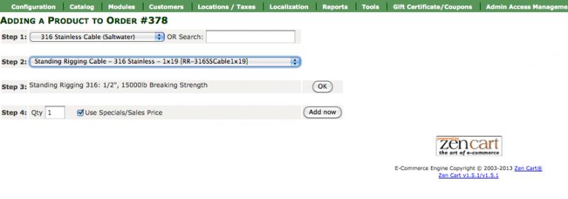

After getting edit orders functioning again, I am noticing I do not have a dropdown on adding additional orders for priced by attributes items. The first is a pulldown for product, but no pulldown for attributes like size, color etc. Is there something I must amend?
1.5.1
superorders4
editorders4.1.2
TyTracker etc
There are no other items I know of affecting this, but would appreciate any advice.
