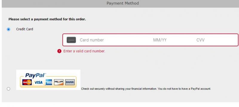

I get the same error with PayPal turned off:
"We have a problem on our end. So Sorry! Please report this error to the Store Owner: SQ-MISSING-TOKEN"
If PayPal is turned ON and credit card is checked, but not entered, I get a friendly reminder to enter credit card number before proceeding to page 3 of checkout.
Friendly reminder is much nicer than error on store end.
Attachment 20215
Code:[16-Feb-2023 14:23:08 America/Chicago] PHP Notice: missing token result: check if card button is disabled on dev console using: document.getElementById('card-button'); else look for javascript error in console. in /includes/modules/payment/square_webPay.php on line 234
