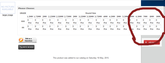

Attachment 15304I have a problem with the layout. my attribute box is going out of my web page area. I have attached an image file. Could you please let me know the change I need to do to make it display in multiple rows
thank you for reading

Re: Product Attribute Grid
nishajh
I thought the sort order of the option name(s) modified which is along the header and which is along the side. Per the README.txt of the download package from version 1.2, step 7:
NOTE: Attributes appear in SORT_ORDER, so the lowest sort number is at the LEFT of the grid, and the highest sort number is on the TOP of the grid.
Make it so that Round Size has a lower sort order than Grade, whatever sort orders those two have.
