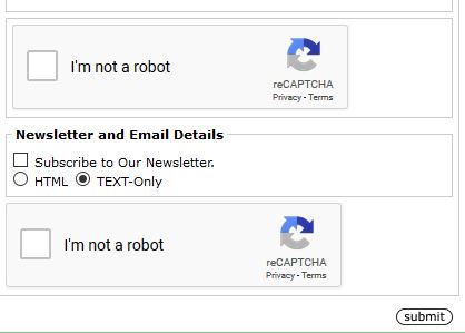

Jim,
OK, so upon further checking, I figured out the template filename and added the respective <?php echo recaptcha_get_html(); ?> to what I thought was the right location within the file. It however, presents the Captcha box input form twice. I tried in three different locations within the form and it did the same thing. Am I missing something as to what is going on?
James

Jim,
This is what I am seeing on the Create Account Page:
Attachment 18690
James

Jim,
I am all set, I have been able to figure out where the issue was and have it down to one Captcha Box. Thanks again.
