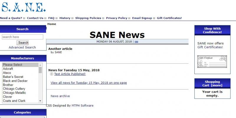

2) When I view a news article, I see the subject, the byline, and then it skips the article text entirely and goes to the HR and then the articleLinkList. Attachment 18005.
If you want to see it in action, it's here: http://www.sanefcs.com/catalog/?main_page=news. If you check out the page source, you can see where the article text is being skipped. I don't know PHP well enough to know what's wrong. The best I can do is find where the articleText function is defined, but I can't understand what it's doing.
