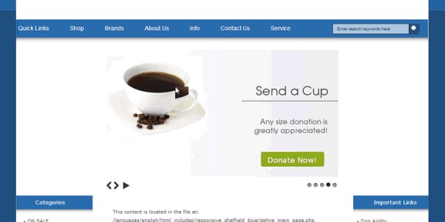

i swapped the narrower slide display from avonlee into sheffield... how/where can move the left/right side columns up to just below the nav bar so there is not that blank space on either side of the slide display? thx
Attachment 13746

It was not necessary to do that. You could have just adjusted the width and height of the slider already in the template. Move the call for the slider from the tpl_main_page.php to the define_main_page.php file.

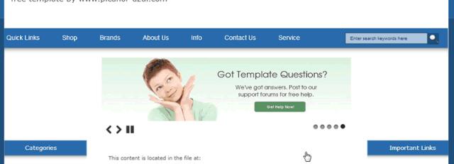

after swapping back, i edited the stylesheet_slide.css and made the container width 550px, but the side columns did not move up...
/* For larger displays */
@media (min-width: 1200px) {
.container {width: 550px;}
Attachment 13748

That will only adjust the width. You need to move the call for the slide show from the tpl_main_page.php file to the define_main_page.php file.
