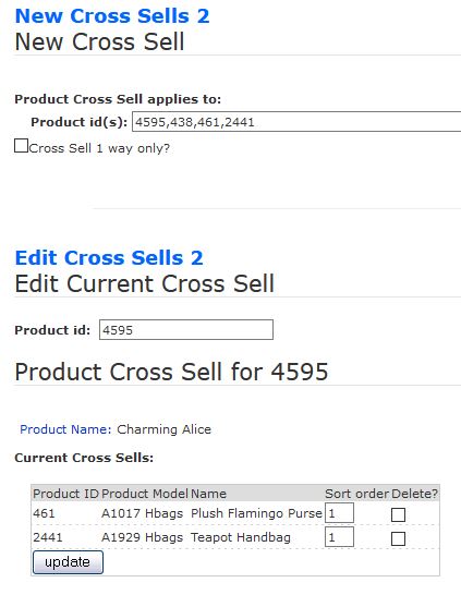

Hello, after updating to 1.5.6c the module is still working.
Products all show correctly as before (1000s of them)
However, when viewing existing cross sells, the first item is not in the list, always.
(Example shown)
It is showing in the row of comma separated ids, but not in the other area, so I can't delete or change sort order.
Any ideas why the first isn't showing?
First number is main item, other 3 are linked items.
But further down the image there are only 2 linked showing.
Attachment 18941
