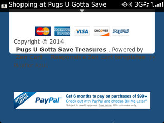

On another note, and I don't remember seeing this discussed. At the bottom of the template the default includes text like powered by Zen Cart and your tagline. I have seen when accessing the template from a mobile device or I think when viewing on a browser that has been horizontally shrunk that the tagline dips down below the lower white edge of the "main body". I haven't been able to tell how to/where to increase the height of the border in that area so that the text is always atop the white area. I might be able to change the text color to something that works on both the blue and white backgrounds, but I like the color scheme for when the text is on white. I don't recall adding text to force the content to be pushed down off of the white area, but I could be wrong. Even if I did, I would like to resolve that visualization.
I am sorry, but I don't understand which text you are talking about. Can you post a screen shot with the text pointed out?
Attachment 13751. This is a view as seen from a cell phone. Am beginning to think it is the added text that is causing part of the problem.
I am still having a hard time seeing the text. Can you post a link to the site?
Not to be facetious, but exactly! :) (although really I think you mean you are unable to read/see it because of the "clarity")
shop pugsugottasave org
Or
Donate pugsugottasave org
Your choice :)
Or
Your choice :)
I can not see the problem on the live site because at the smaller widths there is a horizontal scroll bar caused by the zazzle box.
I don't see the problem on the template demo site with the bottom text.
