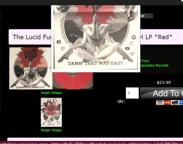

Re: Hover image alignment
Fuzztrip
157c
fuzztrip.com
Using the hover feature, images are opening toward the top of the page, cutting them off. I'd like to get them centered, or to the right of the image I am hovering on. Thanks!
Attachment 19820
Link to specific page.
https://fuzztrip.com/lp-c-1/the-luci...red-p-255.html
