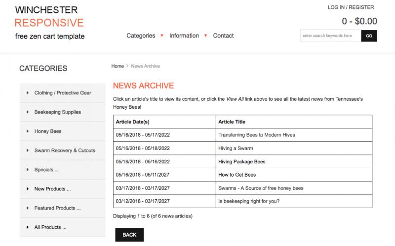

Now if I can teach myself CSS and how to change just the link colors to
Black text or maybe leve it white but give it a Black background in the table would be the easiest fix!
Anyone out there willing to give me a hand PLEASE. As any changes I attempt effects the whole template not just the News Archive Table!
Here is the small amount of code form the STYLESHEET_NEWS_BOX_MANAGER.CSS file.
Can anyone assist me!
#newsscrollbox ol { margin: 0; padding: 0; list-style-position: inside; }
#moreNewsDefault .news_header { font-weight: bold; padding-right: 0.3em; }
#moreNewsDefault .newsContent { padding: 0.3em 0; }
#news-table { display: table; border-collapse: collapse; width: 100%; margin: 0.8em 0;}
.news-row { display: table-row; border: 1px solid #444; }
.news-heading { font-weight: bold; }
.news-cell { display: table-cell; padding: 0.5em; border: 1px solid #444; }

Attachment 17931

I actually started playing with the Back ground colors as well as the back ground colors and I think what I have come up with will work just fine for me!
The way I tried earlier really did not to get it to look correct but then I started thinking about what you said about the back ground color and that did the trick. For me anyways!
I edited one line out of the code I had shown earlier
I changed this :
to this
.news-cell { display: table-cell; padding: 0.5em; border: 1px solid #444;background-color:000; }
and I went from this:
Attachment 17935
To this:
Attachment 17936
and as you can see it more closely matches the rest of the Winchester_black template!
This appears to work and I will continue to test it on my test server to see if it effect anything other than just the one table in the News_Archive!
So We just fixed what I was told by one of the people who developed the Template could not work with the News Archive. As far as I can tell we moved 1 CSS file and addone bit of Background color CSS to the file! STYLESHEET_NEWS_BOX_MANAGER.CSS that we moved earlier!
