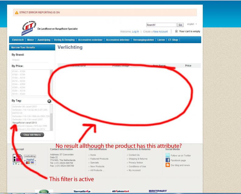

Im having some problems with this mod,
For some of my attributes this is working perfect but when adding more then 4 attributes to a product it fails to give me any results (when filtering)
Attachment 13864
Here it shows the product attributes for this product!
After filtering, it does not show me the results allthough this product does have this attribute
Attachment 13865
This is the url that is being generated by the script:
Attachment 13866
I have not been able to find where the problem occurs, anybody have a pointer which can help me get this script functional ?
thanks a lot in advance
Ive looked in /cache/ logs files but it does not show me any errors, ive allso enabled strict error reporting, does not work too (no error message)

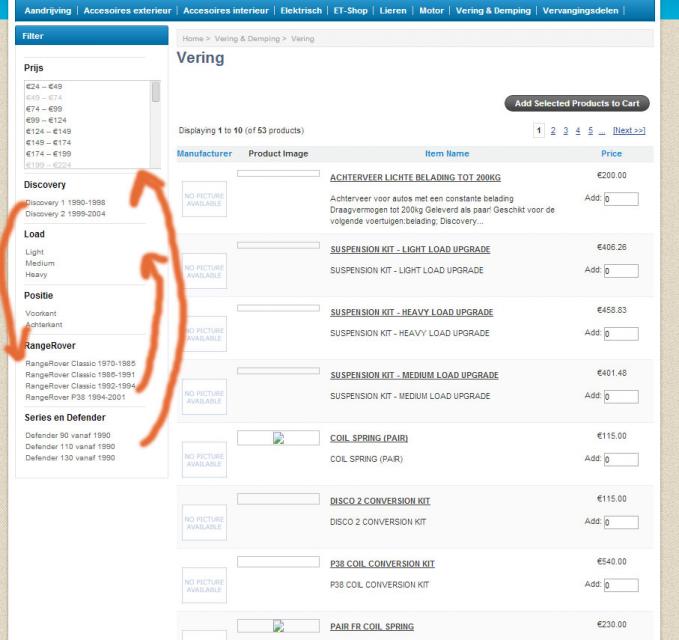

Anybody know if it is possible to change the sort order of the items in the sidebox ?
i have tried playing around with the sort order in the zencart admin but it does not give any results !
Attachment 13902
Im also looking for a method to collapse the panels withing the sidebox, anybody got something working for this ?
I would like to be able to click the option name (the filter name) and then collapse the available filter options !
maybe somebody can point me in the right direction
this will explain the problem i have a little better
when i change the sort order around (like change number 2 to 98) it still shows in the first position

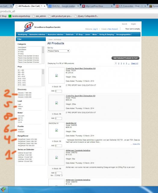

here some screenshots to explain better
Attachment 13904
Attachment 13905
changing the sort order around does not result in another order :P
who can point me in the right direction ?
Managed to fix the sort order;
open includes/templates/YOUR_TEMPLATE/sideboxes/tpl_dynamic_filter.php
FIND:
REPLACE WITH:"Code:if(count($filteredProducts) > 0){
// Below line counts up all quantities of each item. e.g. if a glove is available in Small and Medium, quantity = 2.
//$attributes = $db->Execute("SELECT po.products_options_name, pov.products_options_values_name, count( p2as.quantity ) as quantity" .
$attributes = $db->Execute("SELECT COUNT(DISTINCT p2a.products_id) as quantity, po.products_options_name, pov.products_options_values_name," .
" SUM(IF(p2a.products_id IN(" . implode(',', $filteredProducts) . "), 1, 0)) as flag" .
" FROM " . TABLE_PRODUCTS_ATTRIBUTES . " p2a ".
" JOIN " . TABLE_PRODUCTS_OPTIONS . " po ON p2a.options_id = po.products_options_id AND po.language_id=" . (int)$_SESSION['languages_id'] .
" JOIN " . TABLE_PRODUCTS_OPTIONS_VALUES ." pov ON p2a.options_values_id = pov.products_options_values_id AND pov.language_id=" . (int)$_SESSION['languages_id'] .
(defined('TABLE_PRODUCTS_WITH_ATTRIBUTES_STOCK') ? " JOIN " . TABLE_PRODUCTS_WITH_ATTRIBUTES_STOCK . " p2as ON p2a.products_id = p2as.products_id AND p2as.stock_attributes LIKE CONCAT('%', p2a.products_attributes_id, '%')" : "") .
" WHERE p2a.products_id IN (" . implode(',', $unfilteredProducts) . ")" .
(FILTER_OPTIONS_INCLUDE != '' ? " AND p2a.options_id IN (" . FILTER_OPTIONS_INCLUDE . ")" : '') .
(FILTER_OPTIONS_EXCLUDE != '' ? " AND p2a.options_id NOT IN (" . FILTER_OPTIONS_EXCLUDE . ")" : '') .
(defined('TABLE_PRODUCTS_WITH_ATTRIBUTES_STOCK') ? " AND p2as.quantity > 0" : "") .
" GROUP BY po.products_options_name, pov.products_options_values_name" .
" ORDER BY po.products_options_name, pov.products_options_values_sort_order");
Now the filters are sorted by products_options_sort_order (the order u set in the admin when adding the new attributes) instead of alphabeticallyCode:if(count($filteredProducts) > 0){

After more digging, I've found out that its not 4 attributes thats my upper limit, its more randomly than that.
Adding/removing attribute values from a product change if the filter for that particular filter works or not.
An example. A product has 6 attributes with in total 15 attribute values. The filter on attribute "stock" does not work.
I remove one attribute value from one of the other attributes, for instance a color.
Now the filter on attribute "stock" works just fine.
It doesnt matter what attribute value I remove, so its not just one attribute or value which causes this... hmmmmmmm.....
suggestions?

Here you can see how buggy it is:
http://www.etcoevorden.nl/shop/index...ex&cPath=23_42
This shows a lot of products, but when clicking on the "Discovery 1 1990-1998" Filter on the left side
It doesnt show me any results (in the bottom it shows -> Artikel 1 tot 10 (van 18 artikelen) (so it should have at least 1 result)
If you check one of the products in this category -> http://www.etcoevorden.nl/shop/index...&products_id=8
It does show Attribute -> "Discovery 1 1990-1998" in the bottom so it should be able to find it ?
