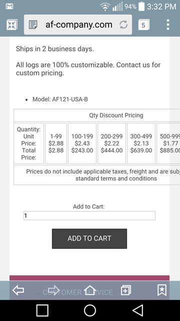

Quantity Discounts Table
Good afternoon,
I am working on our new site, but I can't figure out how to get the quantity discounts table to display nicely on mobiles. I'm sure it's a simple fix, but any help would be appreciated!
Thanks in advance
Colleen
Attachment 15426
Re: Quantity Discounts Table
margecc
Good afternoon,
Thanks in advance
Colleen
Attachment 15426
That's because it is a table and tables are not mobile friendly ;) There are various javascript and css/js solutions out there. If you do a google search for responsive tables you will find them :) I have one implemented on my table here:
https://www.picaflor-azul.com/zen-ca...plate-packages
View it on a desktop and your phone.
I had a hunch that was going to be your answer LOL! Thanks for pointing me in the right direction.
