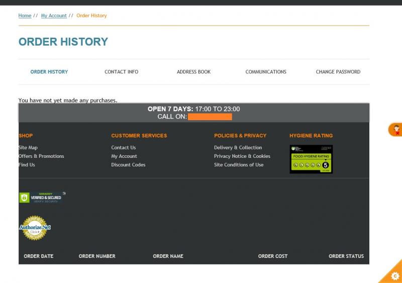

Hi All.
Any ideas how to resolve a little bug I found? I use Zen 1.54 & PHP 5.4, The template is Version 1!
In The "Account" section, when no orders are present and the "Order History" screen is selected I get the footer mounted where the order details would normally sit, see attached pic.
Attachment 15659
Really don't know what causes this so thought would put out to the community.
Thanks in advance for any suggestions. :smile:
P.s. I love this template. It's probably one of the best free responsive templates I have ever found and use it on more than one store (yes bug in all stores I have).

Re: Tableau Responsive Theme - Support Thread
SpaceMonkey
Hi All.
I do not have this bug showing up on mine, but I do remember having to do a little tweeking on the account pages... also see if the bug mentioned on GitHub HERE could have anything to do with it.
Looking at the stock tableau 1.6.6 tpl_account_history_default.php and mine this bug fix is the only difference. I didn't notice anything in the footer that would cause this...
