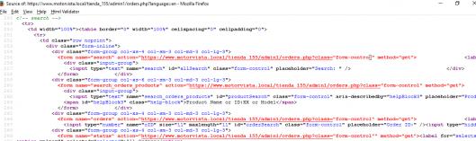

If you browse the site with a smartphone (or with an agent switcher from a PC) when you go to the login page you get a full blank page.
Test if you want at www.aupgrade . acquatua.it (it is a test site so do not watch at the missed parts or bad looking style)
I browsed the page source and I can not find any difference in the code generated when swithched to mobile or tablet, but again the rendered page is blank and if the switch is set "desktop" the page is rendered normally.
I have no error log files thrown, so I am lost.
I think it is a css problem, but I have no idea on how I can fix it.
I set the CSSJs loader to false for both css and js but no change.
Can someone help please?
Ciao from Italy
enzo

I found it. It was the html header in the common dir. It needs to be modified ina different way then what suggest by the plugin author.
enzo

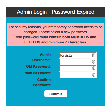

ZC 1.5.5, downloaded "today" (headers reflect full version non-beta).
Created a new database, pointed my configure.php files to the new database including updating the prefix.
Imported ZC 1.3.8 database into the blank database (although it had the applicable drop/truncate commands)
Admin table already had some issues as some admin_level fields had a zero, one had a one.
Username/password was definitely expired.
Used the How do I change or reset my Admin Password? (I lost it) to establish a username to support the database upgrade.
Upgrade only on ZC 1.3.8 database.

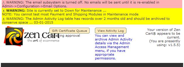

Logged into admin with mobile device.
Nearly the entire lower half of the screen is taken up by logo, copyright, etc... Be nice if that could be turned off in some way.
Menu button on upper right corner doesn't work.
Only options are the log viewer and currently the gift certificate queue because the database did have a gift certificate to get validated from back when it was backed up. Once I clicked on one of these, the half screen problem section disappeared, so at least it does go away eventually, but if I go back to my admin directory /index.php the "popup" appears again. Further, pretty much have to know all of the commands (or use alt_nav.php) to navigate...
Have seen conversations about the grid framework, etc... Don't really care as long as it works.. I do think that having one on one side and the other on the other side offers an opportunity and method to see/choose what it would take for one or the other. So, how does one turn off this admin template thing or what is needed to "correct" the issue?
There was a pending PR that hadn't been merged yet ... to deal with that footer issue. Should be okay now.
Which mobile device are you using? Screen resolution dimensions?
Will take a look-see about merging the PR for that.
DrByte
Blackberry 9930, 640 x 480 pixels... While it is touch screen, it does have single mouse button click capability like a macintosh basically.
Button responded as if moused over, correction, but when clicked no change, not in screen not in response; no action occurred..

The four commits up to commit: 7145bb6061c2b6cc3863c3ef71fd201aed14f3e1
Seemed to fix things.. I saw that there were a few PRs in the queue. I didn't try to apply them to see what would change, but the work done Saturday to Sunday did resolve the mobile in admin navigation issue.
I did notice one thing that still looked a little off, the button to accept related to gift certificate queue, overlaps the ZenCart logo slightly. There isn't much room to move. To the right, because the button for the activity log is adjacent. That second button does have some room to move right, but I find it difficult to provide clear coding direction.
With regards to the overlap of the first button, the lower left part of the button itself begins half way up from the a n the logo. The text description beneath it is somewhat lost at the beginning within the logo. The C in Certificate is position over the lower part of the t in ZenCart. Two fixes come to mind, either move over the Gift Certificate Queue button and hopefully the second button also would move or reduce the size of the logo in this setup...

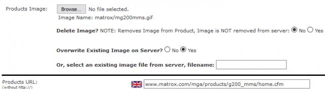

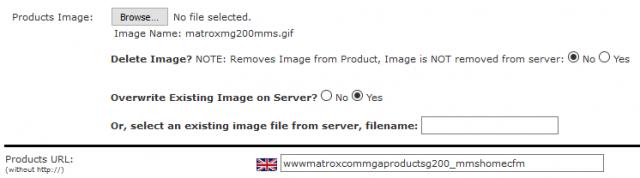

Admin Edit Product->Preview screen strips slashes.
This is simply opening the edit product page, then continuing to Preview. At this point the image will be missing as the slashes have been removed from the path, saving the changes will save the now-incorrect paths as shown.
Before:
Attachment 16102
After
Attachment 16103
Server OS: Windows NT E5540 6.2 build 9200 (Windows 8 Business Edition) i586
HTTP Server: Apache/2.4.12 (Win32) OpenSSL/1.0.1l PHP/5.6.8
PHP Version: 5.6.8 (Zend: 2.6.0)
Database: MySQL 5.6.24
Before:
Attachment 16102
After
Attachment 16103

Re: FEEDBACK ON BETA of v1.5.5
May have problems with slashes in other places as well then, product's name, product's description, product's uri, and product's image. They either have stripslashes( or htmlspecialchars(stripslashes( wouldn't/shouldn't be an issue if something in advance added slashes, or it was processed in some other way, but as is, looks like slashes that are purposefully entered as a single slash are removed in the processing.
torvista
Before:
Attachment 16102
After
Attachment 16103
Design75
And this also happens with the url, according to your images.
Have done a PR https://github.com/zencart/zencart/pull/870/files
which should fix this.
admin password changing fields mis-aligned. Screen fully maximised.

While examining admin orders.php
1) these form urls have quotation marks and spaces. Are these not considered unsafe characters and so should be encoded?
Attachment 16117
embedded image will not popup so here is an example:
(Note this image is a gif and named as such but the forum software insists on naming it as a jpg)
2) This page has a lot of changes. Why not change the current admin doctype to a valid html5 one to allow the new ids, datatypes etc?

torvista
That was resolved in one of yesterday's commits.
torvista
Oops. The class was added as a URL param instead of a form param.
Commits completed.
torvista
... cuz the rest of the page is still full of HTML4 markup and will blow up in your validator :D
